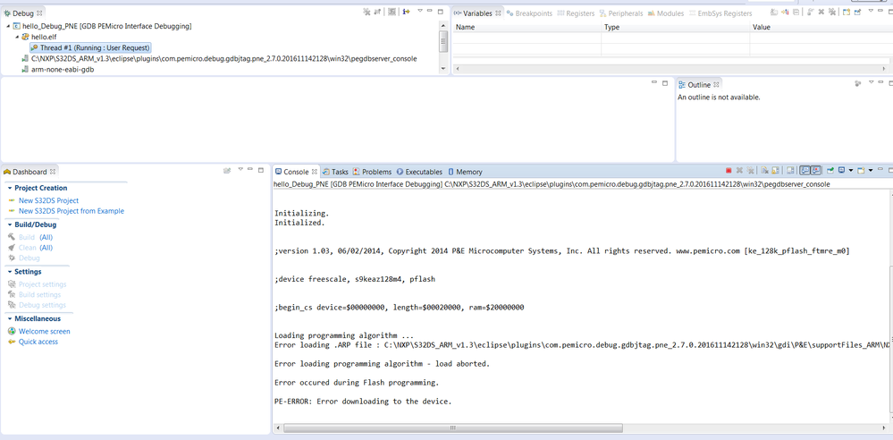

HI,
after update i can not debug any more....
Adrian

jiri_kral
Hi Adrian,
I can't reproduce your issue - but I see that you have different PE micro debug plugin version. After last update - I have on my machine installed  com.pemicro.debug.gdbjtag.pne plugin ver. 2.9.6, your vesion is 2.7.0.
As a quick fix without any investigation - just update PE micro plugin
https://community.nxp.com/thread/447395?commentID=890477#comment-890477
Jiri

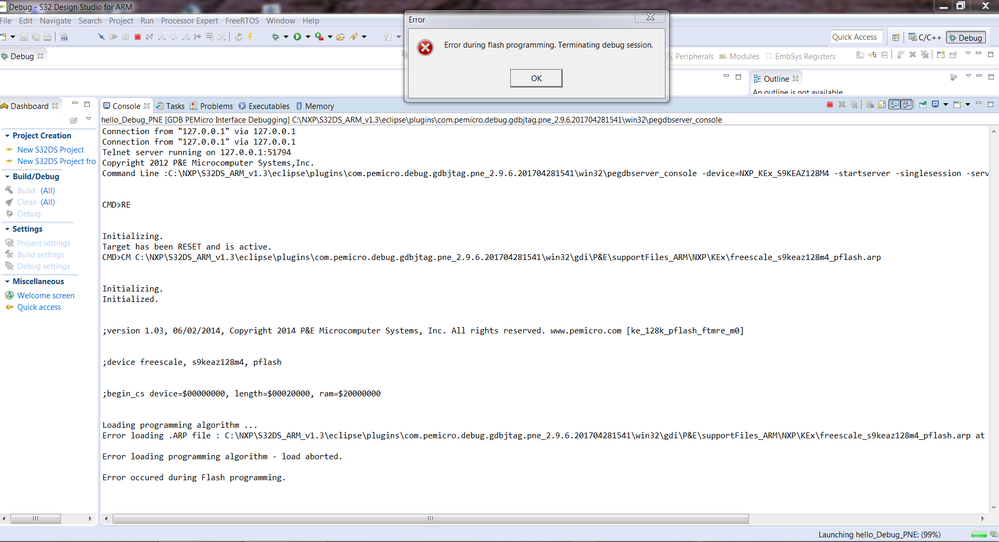

adrianwenger
if i use the version 2.9..., the same error appears:

stanish
Hello Adrian,
you posted that you are targeting S32K144EVB but your GDB console shows NXP_KEx_S9KEAZ128M4 which is completely different part. This is the reason why flash programming fails - you target MCU and flash programming algorithm must match.
I'd recommend you:
1) create a new project and select the device you are targeting (S32K144).
2) open debug configuration dialog  (Menu Run -> Debug Configuration)
3) select the appropriate configuration for your project (typically there are 3 variants for each build configuration - RAM_Debug, Debug, Release), Debug interface (assume you use OpenSDA) and click on "Debug" button
Are you able to run the debug session?
Stan

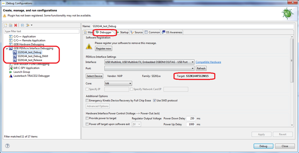

adrianwenger
2,729 Views

adrianwenger
yes, i use the S32K144EVB
regards
