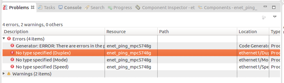

Hi there,
when we try to build the "enet_ping_mpc5748g" example from the "S32 SDK EAR 0.8.0", we meet some errors on the ProcessorExpert code generation phase, error info as attached (we have followed the tip inENET on DEVKIT MPC5748G about "adjust  ENET0 RMII Transmit Clock pin as output and regenerate code" to fix the first issue of this example already.) -
we cannot select any other options for the "MII configuration" except "-1", the related settings in the ProcessorExpert.pe file are -

we tried to modified this section in the ProcessorExpert.pe file manually to be the following, but when we run ProcessorExpert to regenerate code, those configs are changed to be "-1" again.  Can anyone help on this ?

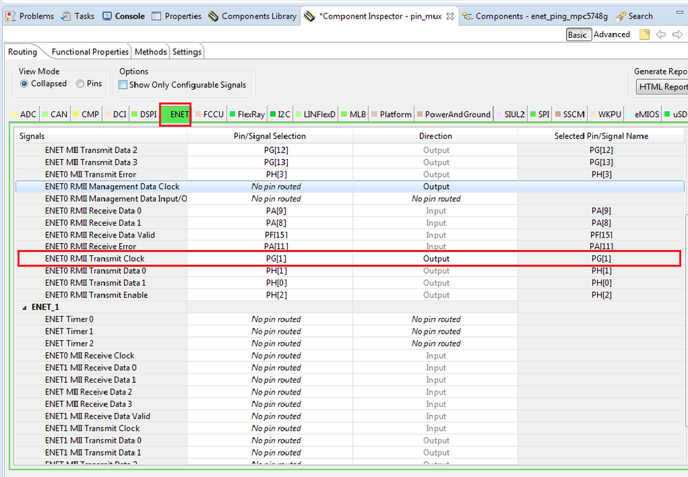

martin_kovar
I have already had an issue to generate code from Processor Expert. I set PG[1] as output in Component Inspector and now I am able to generate code and also compile the project. Please check the figure below:
Please let me know, if you are able to reproduce it on your side.
Martin

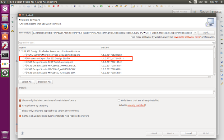

What do you mean by "SDK is not supported in Linux version of S32 Design Studio and because you do not have Processor Expert available"?
On Ubuntu, I can install "Processor Expert" from "S32 DS > Help > Install New Software.."(attached screenshot) and I can build other SDK examples like hello world and freertos successfully which also use Processor Expert to generate codes, only the "enet_ping_mpc5748g" example has some errors on the "MII Configuration" options as attached in the original post.
Thanks!

jiri_kral
Hi James,
unfortunately Processor Expert is not working correctly under Linux - and also is not officially supported/tested yet. For some projects the PE may be working - for others like enet ping - is not working.
As Martin suggested - try to run your project under Windows. Other way is take generated source code from Windows and use them in your project under linux (without regenerating sources by Processor Expert).
Jiri
