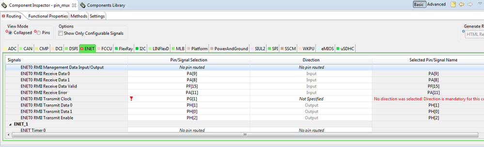

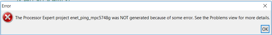

When I try to build the processor expert code from the example - enet_ping_mpc5748g, I get the following error. Do we need to do some other config for this to work?
Can anyone help to resolve the issue?

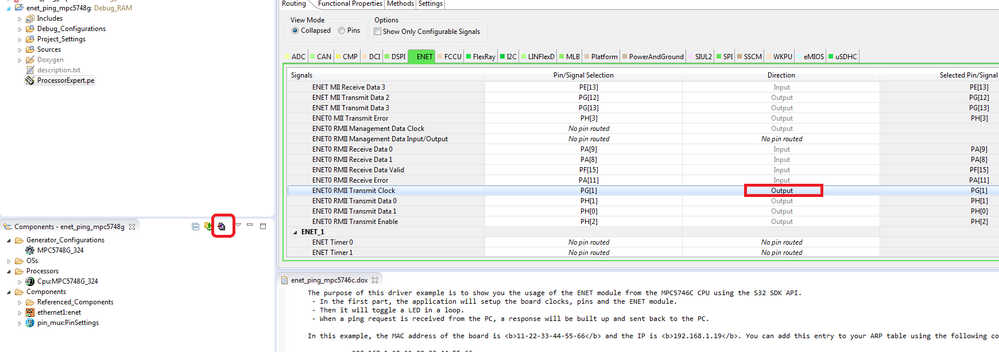

I noticed that the pin_mux component is missing a pin direction setup.
please adjust  ENET0 RMII Transmit Clock pin as output and regenerate code:
Now you should be able to build and debug the project.

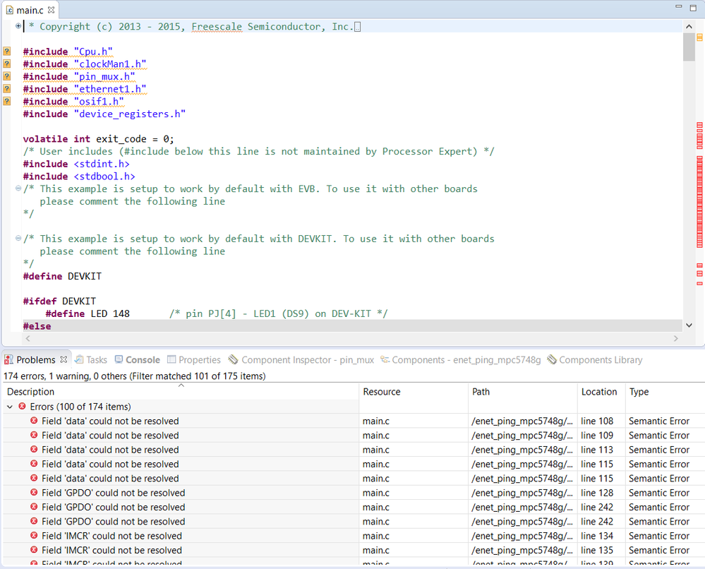

Regarding the C errors in Problem View -> this is a known eclipse issue, please try the workaround described here:
https://community.nxp.com/message/924323#comment-924619

Hi Stan,
Was able to figure out the pin_mux issue out. After that the compile went on fine.
Yes, after adding the arp entry it pings just fine.
