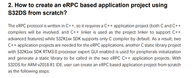

Thanks for reaching out to us. I can recommend you to check the following page and attached document, in which you will be able to see how to configura eRPC with the S32K microcontrollers [page 29]:
https://community.nxp.com/t5/S32K-Knowledge-Base/eRPC-based-Dual-MCU-Sync-Solution-for-S32K1xx-Famil...
Although the document is meant for the S32K1 the process should be also functional for S32K3.
Please let me know if you have specific questions or problems I can help you with.

You can see that you do need to copy the eRPC folder inside your project.
