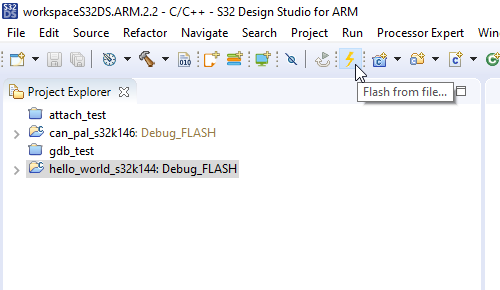

If running a simple hellow world code on s32design studio  ide, while running the code getting error called "PE micro launch failed", As i don't want to debug, flashing the code alone to evaluation board is not happening. How can I view the result ?

I'm not sure what you mean by - How I can view the result. For flashing the binary into target MCU you can simply click on Flash from File button:
Then select debug probe (default one is PE Micro - but it depends what's your target MCU) and click on Flash button:
Or what is your approach? Can you please share more details?
