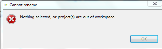

I can not rename my project. did anynone know how to fix this problem?

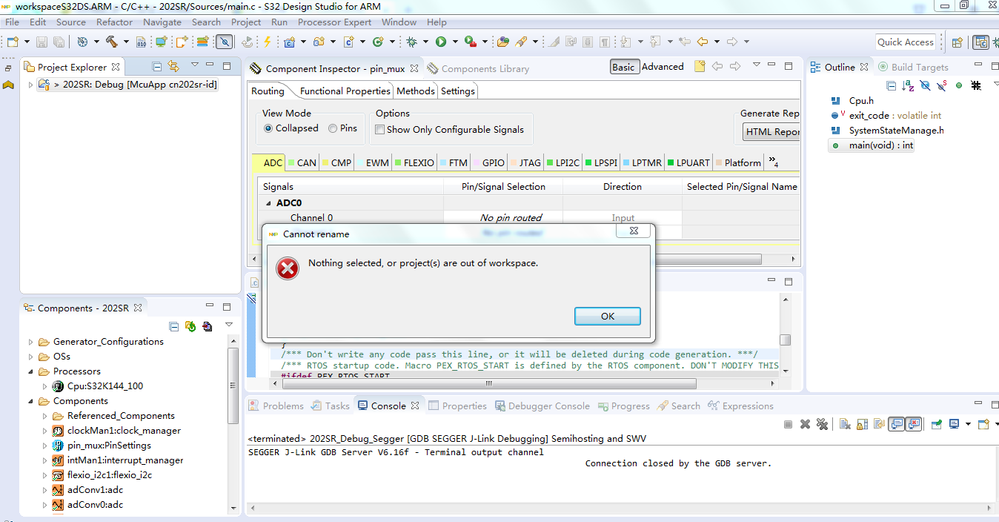

maojun
    this is my full screenshot,I used F2 key to rename my project,but it pops this .
4,130 Views
jiri_kral

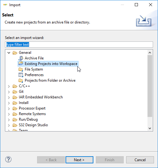

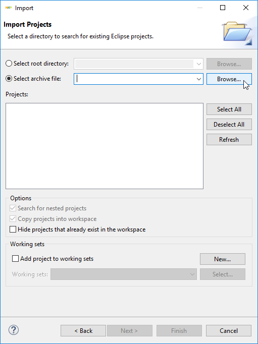

your project is not part of workspace - you probably opened it as project from file system.
Importing project into workspace should solve your issue:
and select your project directory or project zip archive:
Jiri

maojun
It really works,thank you very much.
