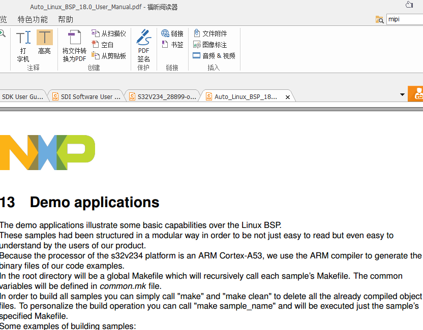

     I find that the chapter13 of Auto_Linux_BSP_18.0_User_Manual.pdf, it mentions that there are some demo applications for S32v234 Linux BSP as below picture.But I cannot find the Demo application, can you tell me where I can download the demo application source code?

hi, I found some demos here.
/home/YourAccount/VisionSDK_S32V2_RTM_1_2_0_HF1/s32v234_sdk/demos/apex
2,115件の閲覧回数
mikedoidge
Hello zhangweikanghust@163.com‌,
The demos are part of the Vision SDK. If you downloaded the BSP separately from the VSDK, then you will not have the demos, or the libraries, etc. to support them. Here is a link to download the latest version of the VSDK.  https://www.nxp.com/webapp/swlicensing/sso/downloadSoftware.sp?catid=SW32V23-VSDK001E
