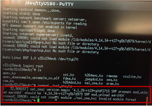

1, BSP 17.0 + s32v234_sdk_1_1_0, I compiled the *.ko with Ubuntu 14.04,and these *.ko files are copied int to root folder of SD card, but when I run commond: insmod oal_cma.ko, the error is shown as following fig_1:
[  32.908157] oal_cma: version magic ‘4.1.26-rt29+g0df2715 SMP preempt mod_unload aarch64’ should be ‘4.14.34-rt27+g5b7d979 SMP mod_unload aarch64’
Insmod Error:could not insert module ./oal_cma.ko:  Invalid module format.

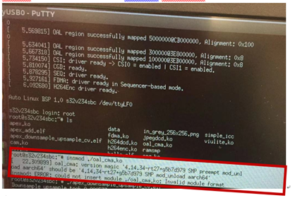

2, BSP 18.0 + s32v234_sdk_1_2_0, I compiled the *.ko with Ubuntu 14.04,and these *.ko files are copied int to root folder of SD card, but when I run commond: insmod oal_cma.ko, the error is shown as following fig_2:
[  22.309899] oal_cma: version magic ‘4.14.34-rt27+g5b7d979 SMP preempt mod_unload aarch64’ should be ‘4.14.34-rt27+g5b7d979 SMP mod_unload aarch64’

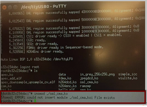

3, I use *.ko files which is included when s32v234_sdk_1_2_0 is installed, and these *.ko files are copied int to root folder of SD card, when I run commond: insmod oal_cma.ko, there is no error , only give the following hint:
Insmod: ERROR: could not insert module ./oal_cma.ko: File exists.
Could you help me again? How can I solve the error of item 1 and item 2? And about item 3, in SD card ,where is the oal_cma.ko which is automatically loaded?

1,2 - you built your kernel module with different kernel version than is on your EVB. That's why you got the version magic error.
3. the kernel module is already loaded. You can use rmod command. In case that rmod is not present on your system, just move oal_cma.ko to different folder and reboot your EVB.

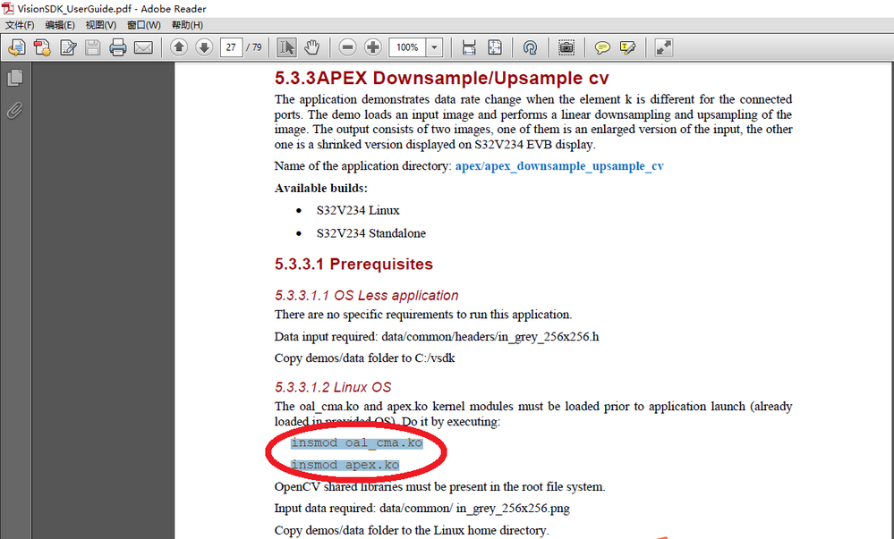

By the way, in SD card , I install the Linux file system with Linux source BSP 18.0 for s32v234.And I debug the demos as the docunment <VisionSDK_UserGuide.pdf>, which shows the oal_cma.ko is needed, the details are shown as following:

With the OS image from VSDK - there are all required modules already loaded. You can list modules with lsmod command. In VSDK OS image are modules stored in /s32v234 direcotory.

there are some errors, shown as the following, I don’t understand what’s the different between “SMP preempt mod_unloade” and “SMP mod_unload”?  and why is the simple_icc_mod.ko invalid module format? How can I fix the error?
By the way, simple_icc_mod.ko is not included in VSDK OS image automatically, so I have to insert it manually.And the kernel version of SD card is shown as following: 4.14.34-rt27+g5b7d979.
