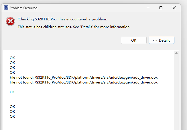

请问在打开S32DS软件的是否会出现这种警告,这个.doc文件如何生成或者修复?感谢!

you can try to reinstall K1 SDK. But it is related to missing doxygen file for generating documentation. The documentation is already there in .pdf format.
