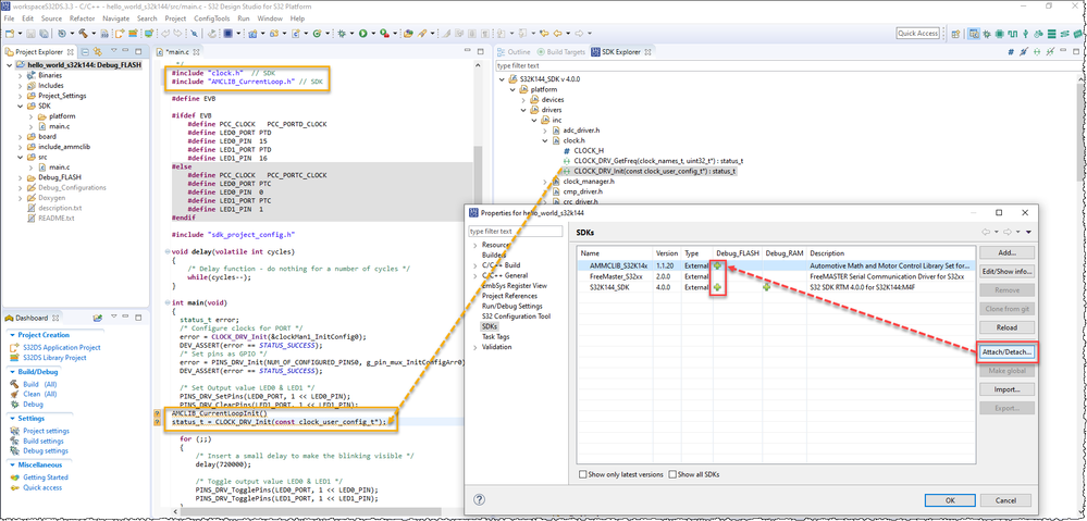

In s32ds 2008 version, I can drag and drop functions to the main window, but in s32ds 3.3 version, this function is not found。

Hi turbozzg,
Please follow the steps in: HOWTO: Working with AMMCLib SDKs
Have you tried "Select the SDK from the list and then click 'Attach/Detach...'"?
Then I am able to achieve it in S32 Design Studio for S32 Platform 3.3.
Robin

In version 2018, drag in the function to the main window to automatically complete the parameters, but in version 3.3, after dragging in the function, just simply copy the function over, without automatically filling in the parameters
2,304 Views
Robin_Shen
Sorry for the inconvenience we bring you!
I am afraid you need to fill these parameters manually.
