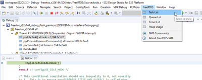

I'm not familiar with TaskAware debugger plugin. S32DS already contains tools for FreeRTOS debugging - Heap usage can be checked by Heap Usage tool:
All tools related to FreeRTOS can be found on main menu bar:
