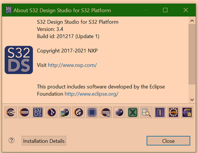

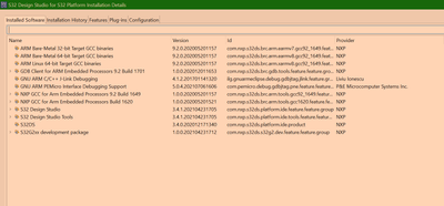

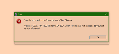

I'm trying to install and build an example project for S32G274A Rev2.
I have to use Platform_SDK_S32G_2020_12 SDK. but S32 Design Studio 3.4 is not supporting this SDK.
Please let me know which is the right version of the tool. below are the snaps of my installation details.
Thanks in Advance
-Ravindra

Can you please explain in more details, what steps did you take before you come to this error? Based on the information you provided, your S32DS is up-to-date, but the package you are trying to use with it is either obsolete or was not publicly released. Note, if you received the problematic software under the terms of NDA, the correct way to request support for it is to open a Support Case.
