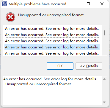

The customer uses windows 11, install "S32DS_ARM_Win32_v2.2",complie ok.
File ->  NEW -> S32DS Application Project ->S32K144 ->SDK ->SDK144_SDK 3.0.0 ->Finsh
In the process of creating a project,there are many errors,as shown below:
My computer performed the same operation with windows 10 without error.

Hi, @rwaghode ,
NXP support the windows and Linux version of host operating systems as listed on NXP website.
As mentioned here: https://www.nxp.com/design/software/development-software/s32-design-studio-ide:S32-DESIGN-STUDIO-IDE
And release notes : https://www.nxp.com/docs/en/fact-sheet/S32DS-FS.pdf
But, "it may work on windows 11", or may have some issues while installation, as it is not tested on Windows 11.
The listed operating systems on the release notes are officially supported and tested.
Please kindly let us know if you have any further question regarding it.
Thank you. Kind regards.
- Mehul Patel
2,678 Views
mikedoidge
"S32DS_ARM_Win32_v2.2" was never tested on Windows 11. In fact, Windows 11 did not exist yet. "S32DS_ARM_Win32_v2.2" was released on Jan 29, 2020. Windows 11 was officially released on October 5, 2021.
We cannot support OS versions for which this product was not tested.
