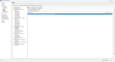

I am working on the S32K344 microcontroller and I need to execute c++ code. After finding out c++ is not officially suported with and SDK project I tried to implement some of the workarounds explained in nxp community pages.
In short, the steps are: create a C project with SDK, add C++ nature, rename main.c to main.cpp, change standard linker file to the linker file created in the project in project settings (see image).
After this steps I am able to build a project with main.cpp, however the objects declared outside of main are not executed or initialized.
One solution i found to this problem is to include  __libc_init_array() at the beginning of main(). The problem now is that this function is not found. How can i add the library to solve this dependence? Is there any other solution to initialize objects outside of main in c++? Console output:

_libc_init_array is part of STD C library (for example libc_nano.a). If you are using C++ you don't need link STD C Library and call _libc_init_array.
