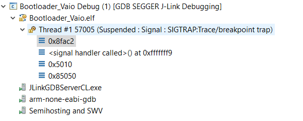

Using: S32K146, GCC Compiler
I'm trying to perform the A/B Firmware Update procedure described in Application Note AN12323.
I successfully managed to perform the flashing from Firmware A to Firmware B using Hardcoded .ld Files (see below) and now I want to perform the same task using Position Independent Code.
What I did:

HARDCODED Linker File for Firmware B
/* Entry Point */
ENTRY(Reset_Handler)
HEAP_SIZE  = DEFINED(__heap_size__)  ? __heap_size__  : 0x00000400;
STACK_SIZE = DEFINED(__stack_size__) ? __stack_size__ : 0x00000400;
/* If symbol __flash_vector_table__=1 is defined at link time
 * the interrupt vector will not be copied to RAM.
 * Warning: Using the interrupt vector from Flash will not allow
 * INT_SYS_InstallHandler because the section is Read Only.
M_VECTOR_RAM_SIZE = DEFINED(__flash_vector_table__) ? 0x0 : 0x0400;
/* Specify the memory areas */
MEMORY
  m_interrupts          (RX)  : ORIGIN = 0x00081000, LENGTH = 0x00000400   /* 1024 bytes 1kB Firmware 1 Vector Table Partition A / -10 for the m_flash_config that is part of this*/
  m_flash_config        (RX)  : ORIGIN = 0x00081400, LENGTH = 0x00000010   /*16 Bytes*/
  m_got                 (RX)  : ORIGIN = 0x00081410, LENGTH = 0x00001000 /*Global Offset Table*/
  /*All Code -> example: Reset_Handler is the first code located at 0x2400 */
  m_text                (RX)  : ORIGIN = 0x00082410, LENGTH = 0x0007DC00 - 0x1410    /*503 kB Firmware 1 partition A TODO die length von m_flash_config subtrahieren*/
  /* SRAM_L Adresse_Start 0x1FFF_0000 and Adress_End 0x1FFF_FFFF*/
  m_data                (RW)  : ORIGIN = 0x1FFF0000, LENGTH = 0x1FFFFFFF/*uses all 64kB or 65536 bytes of SRAM_L since it will be cleared when jumping*/
  /* SRAM_U Adress_Start 0x2000_0000 and Adress_End 0x2000_EFFF*/
  m_data_2              (RW)  : ORIGIN = 0x20000000, LENGTH = 0x0000F000 /*Uses all 60kB or */

According to the Application Note, this should be enough to flash at any memory address of my choosing. I perform the flashing the same way I did when the .ld was hardcoded, and my bootloader is able to receive the correct Stack Pointer (SP) and Program Counter (PC). The jump is successful, but then it crashes at Address 0x85050.
00085020:   cpsid   i
00085022:   mov.w   r1, #0
00085026:   mov.w   r2, #0
0008502a:   mov.w   r3, #0
0008502e:   mov.w   r4, #0
00085032:   mov.w   r5, #0
00085036:   mov.w   r6, #0
0008503a:   mov.w   r7, #0
0008503e:   mov     r8, r7
00085040:   mov     r9, r7
00085042:   mov     r10, r7
00085044:   mov     r11, r7
00085046:   mov     r12, r7
00085048:   ldr     r0, [pc, #16]   ; (0x8505c)
0008504a:   mov     sp, r0
0008504c:   ldr     r0, [pc, #16]   ; (0x85060)
0008504e:   blx     r0
00085050:   ldr     r0, [pc, #16]   ; (0x85064)
00085052:   blx     r0
00085054:   cpsie   i
00085056:   bl      0x93964
0008505a:   b.n     0x8505a
0008505c:   vext.8  d18, d12, d0, #0
00085060:   ldr     r4, [pc, #692]  ; (0x85318)
00085062:   movs    r0, r0
00085064:   ldr     r4, [pc, #980]  ; (0x8543c)
00085066:   movs    r0, r0
00085068:   b.w     0x85068
0008506c:   eor.w   r1, r1, #2147483648     ; 0x80000000
00085070:   b.n     0x85078
This represents the first lines of the 'Reset_Handler' inside 'Startup.S' and it looks like it's the line 'ldr r0,=init_data_bss': or 'System_Init'

My assumption is that either my VTOR Relocation Function is wrong or I have to manually add some more configurations after specifying -fPIC in the compiler and adding the .got sections.
Would appreciate any suggestions on what I might be missing or why it is crashing using PIC but not with Hardcoded .ld files. The Application Note Demo Project doesnt have PIC activated so I cant get an understanding from there.
3,117 Views
johnrusso
This part does not look right:
0008504e:   blx     r0
00085052:   blx     r0
00085054:   cpsie   i
Specifically, as an example, the code at 0x85050 seems to be explicitly loading an address from 0x85064, to be loaded into r0 and then call that routine via the blx at 0x85052. But at 0x85064, it looks like another indirection, perhaps the base of the GOT.  (0x85064 - ldr r4, [pc, #980]). So you are essentially loading an instruction bit pattern at 0x85064 instead of a static address (init_data_bss).
Here are some links I found that might be helpful:
Position-Independent Code with GCC for ARM Cortex-M | MCU on Eclipse
https://www.eevblog.com/forum/microcontrollers/bare-metal-arm-gcc-position-independent-code-possible
Cannot build position independent code that works - Compilers and Libraries forum - Support forums -...
c - Compiling and linking position independent code (PIC) for ARM M4 - Stack Overflow
Portable Position-Independent Code (PIC) bootloader and firmware for ARM Cortex-M0 and Cortex-M4 – J...
In particular, the compiler flags:
-msingle-pic-base -mpic-register=r9 -mno-pic-data-is-text-relative -fPIC
seem to be the magic flags to get things to work.
Hope it helps.
