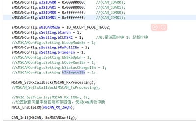

shunyizhang
can init:

Hello, I am using the can module of KEAZ128, and the baud rate is 500k. Currently, can can accept data normally, but when sending data separately, I did not receive data when I measured with zlg host computer or oscilloscope. Please help to find out what the reason is.Attached is the can driver I used.

Robin_Shen
Please test the MSCAN_NormalTest project in SD-FSL-KEA-CD(V2.0)KDS3.0-20150919.rar. It is also recommended to compare the values of MSCAN peripheral registers to quickly check the differences between the driver you wrote and the driver provided by NXP.
