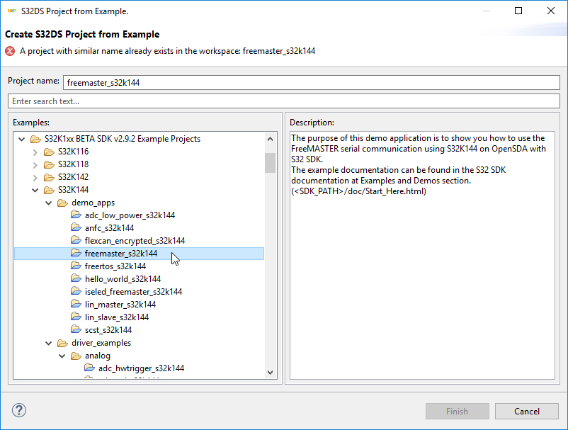

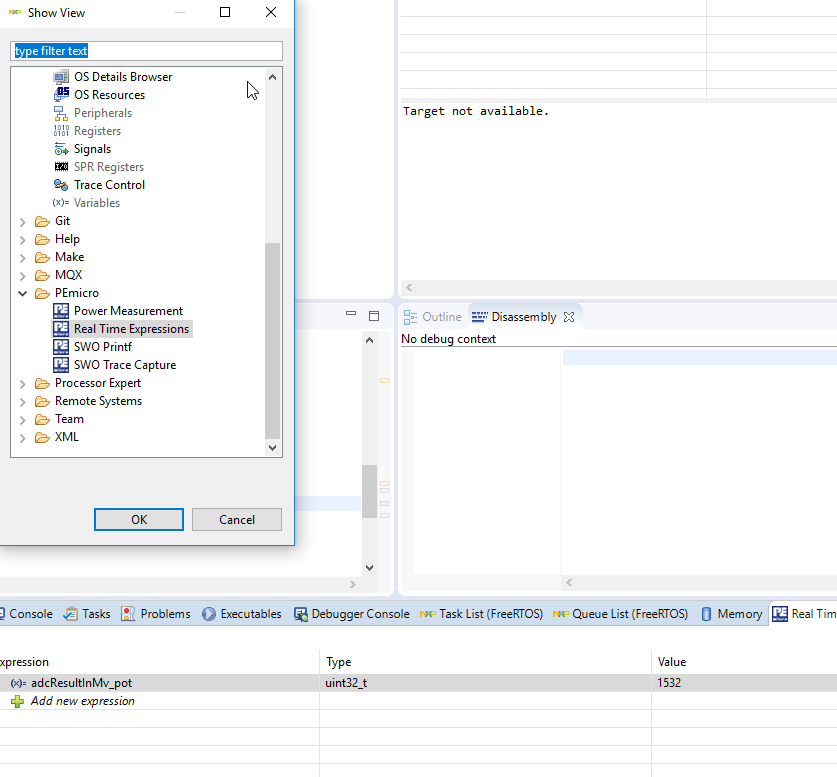

unfortunately this feature is not supported by S32DS. In runtime you can only see values in PE Micro Real Time Expressions:
You can use FreeMaster for that. There is an example in S32DS:

Thank you for fast reply,Unfortunately "ftm_pwm_s32k144" is not useful ,since I'm not using SDK. Actually I want to acquire the potentiometer value to ADC and generate PWM to change the RGB light intensity?...I used
PE Micro Real Time Expressions,if I changed the potentiometer and I have to run the code every time so that I can see the value changing also the intensity..What I need is to see the intensity changing with potentiometer changing without the need to run the code each time !!

sorry, I don't get it. If I understand it correctly - you like to simulate potentiometer output voltage by Debugger in real time, Am I correct?
PE Micro allows only reading values in real time. Value can't be written in real time (you need to stop program, change value, and run it again).
