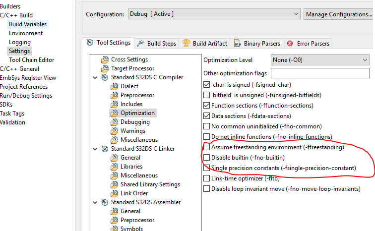

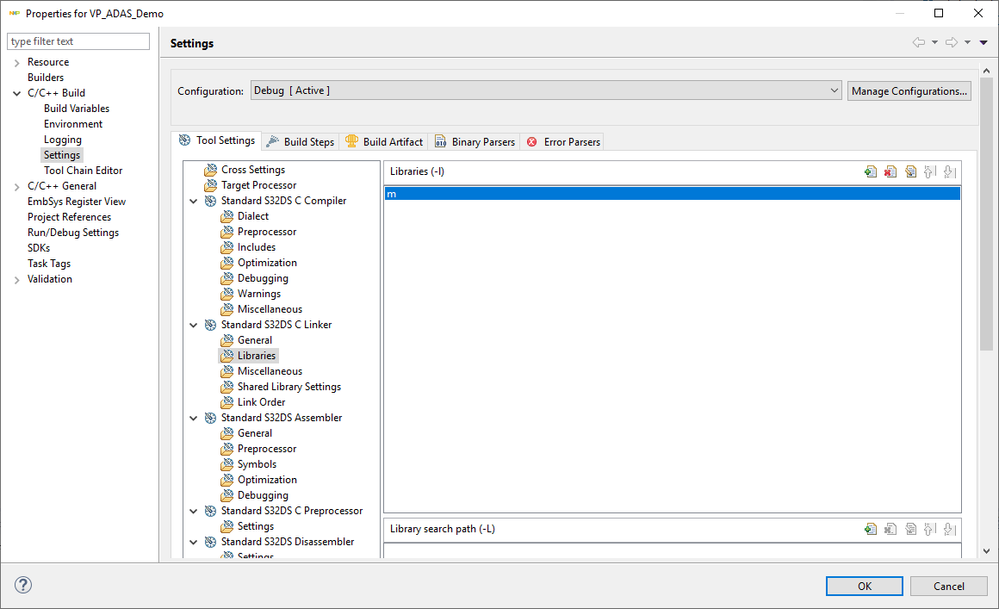

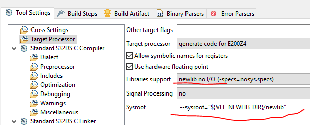

b48014
Do you want to use only EWL library? You can use newlib library instead:
1. Delete #define fabs(x) implementation from your Main_Z4b.c file
2. Add libm library in linker settings and delete "${VLE_EWL_DIR}\lib\e200z4\fp" from Library search path
3. Select newlib in Target Processor settings
I hope it will help. :smileyhappy:
PS: If you still want to use EWL:
1. Delete Release and Debug folders from your project.
2. Delete #define fabs(x) implementation from your Main_Z4b.c file.
3. Uncheck the following settings:
4. You are welcome.

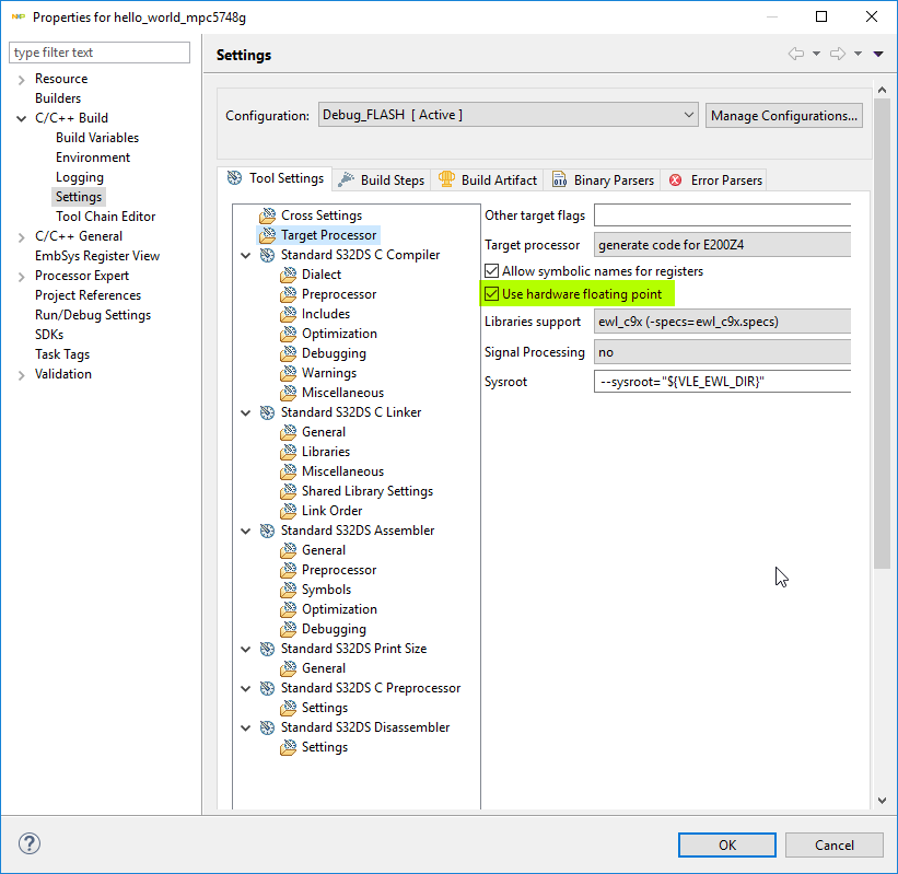

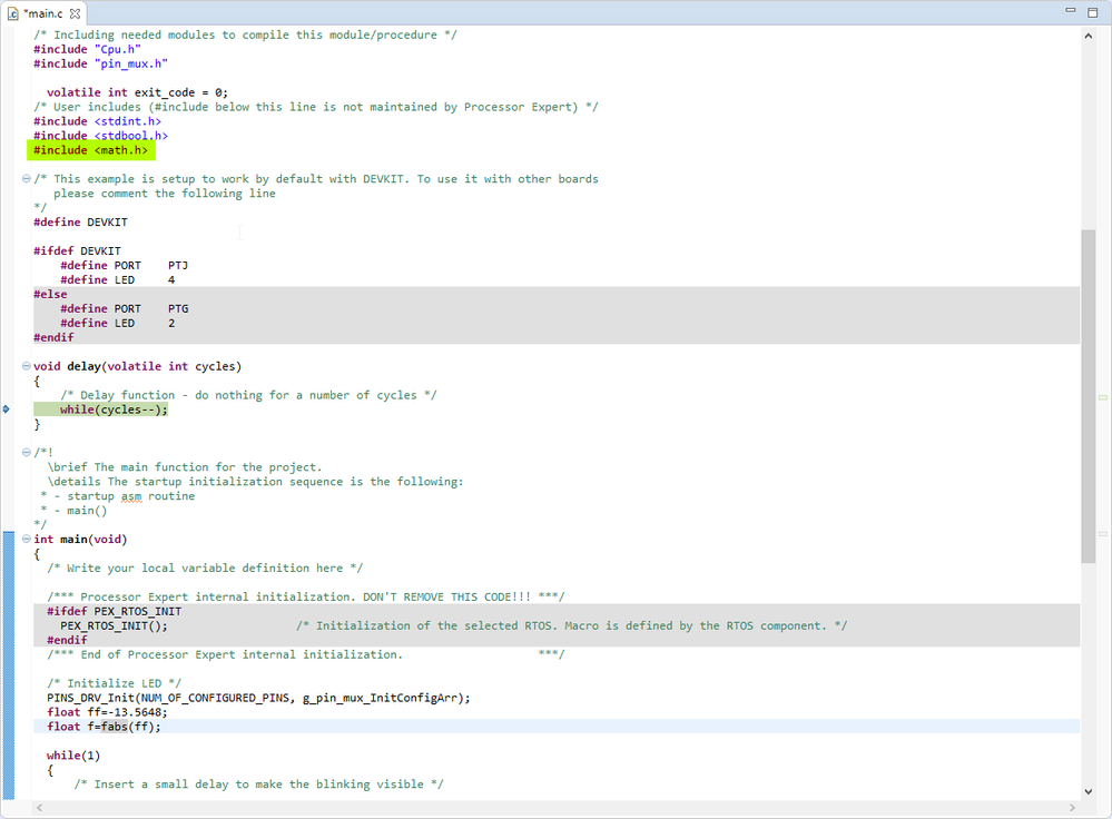

jiri_kral
i tried hello world project - and only what I need to add is #include <math.h>
Also make sure that hardware floating point is enabled in project properties:

jiajian_qiu
Hi Jiri:
   Thanks for your reply.
   I find 'fabs()' can be work in new project, but my project is new by older version S32DS.
   Some head file not similar to new project. The attachment is my demo project.
   I would appreciate it if you could use my project (file Main_Z4b.c line 21).
   PS: I can't rebuild a new project on the new version.
   Best regards.
