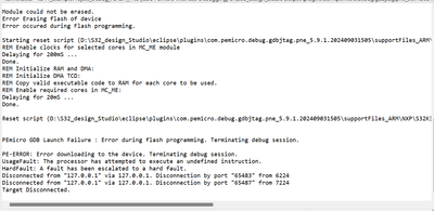

I'm using S32K344 evalution board with Design studio 3.5 version for my product development purpose.
After installation of Design Studio, I have taken example project from RTD version 3.0.0. Then I was trying to debug that example project in s32k344 evaluation board with PE Micro debugger.
When I click debug option within few seconds in console window it was showing Target  Disconnected &  I'm not able to click Run option.
Please suggest a solution for this ? & Let me know if need more information

Were you able to flash any code before? Does this also happens using the OpenSDA? Can you create a blank "S32DS Application Project" and see if the same error appears? Did you make any changes to the debug configurations? Can you share an image of the error message?
Can you please do the following:
- Turn the switch off
- Disconnect the 12 volts
- Reconnect the 12 volts
- Turn the switch on
This power-up procedure manage that SBC starts with the disabled watchdog.
BR, VaneB

Hi @VaneB ,
I have 2 boards.
1) Target board which is having S32k324 Controller.
2)   S32k344 Evaluation Board(257 package).
As per your suggestion i have created  application project for both the controller.
So, there is no problem for S32k324 application project. If I'm trying to flash application project for S32k344 evaluation board then error is occurring. For your reference, I have attached image in below.
But, Same project I was trying to  flash from my colleague laptop then there is no issue. Could you please help me to solve this issue and let me know if you need more information.
Ajay. R

Could you help me check if there is any difference between your setup and your colleague setup? Also, does S32DS show any other errors?
