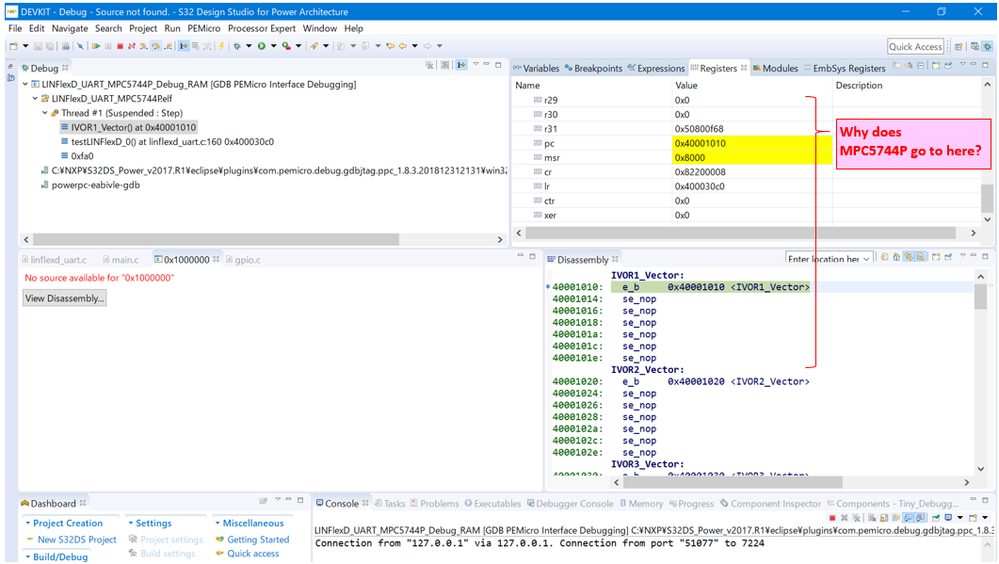

And I have a problem that MPC5744P goes to the IVOR1 vector when the other function call this function in the sample program.
I don't understand why it is occuured ?
Does someone teach me how to solve this problem ?

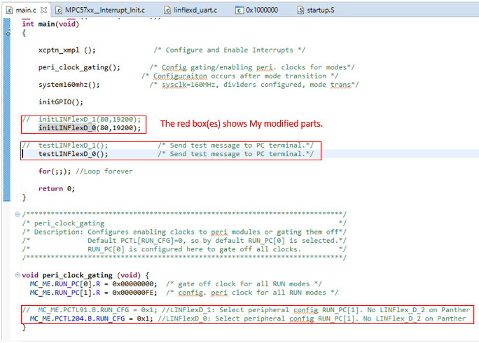

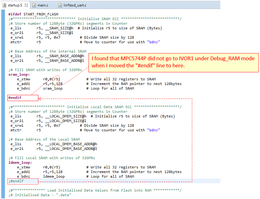

Today, I found that MPC5744P did not go to the IVOR1 vector under the Debug_RAM mode when I moved the "#endif" line in startup.S in shown the below figure.
(Note: I tried it the Debug mode requested from you. And I posted its result already. )
Is this way correct? or  wrong ?
And, are there the concerning points ?
Please teach me them.

sorry for delay. I can reproduce your issue. Thanks a lot for report. I find out that PE Micro .mac script doesn't init RAM for stack. As workaround you can use your part of code. Or you can use modified .mac script from attachment and left the original startup code. In normal way this init should be done by debug probe.
PE Micro .mac script is located (with default install path) in c:\NXP\S32DS_Power_v2.1\eclipse\plugins\com.pemicro.debug.gdbjtag.ppc_1.9.9.201907200403\win32\gdi\P&E\ folder. You can replace existing one with attached file. the only difference is this additional row at the end of script:
meminit.l 0x50800000 0x5080FFFF
Jiri

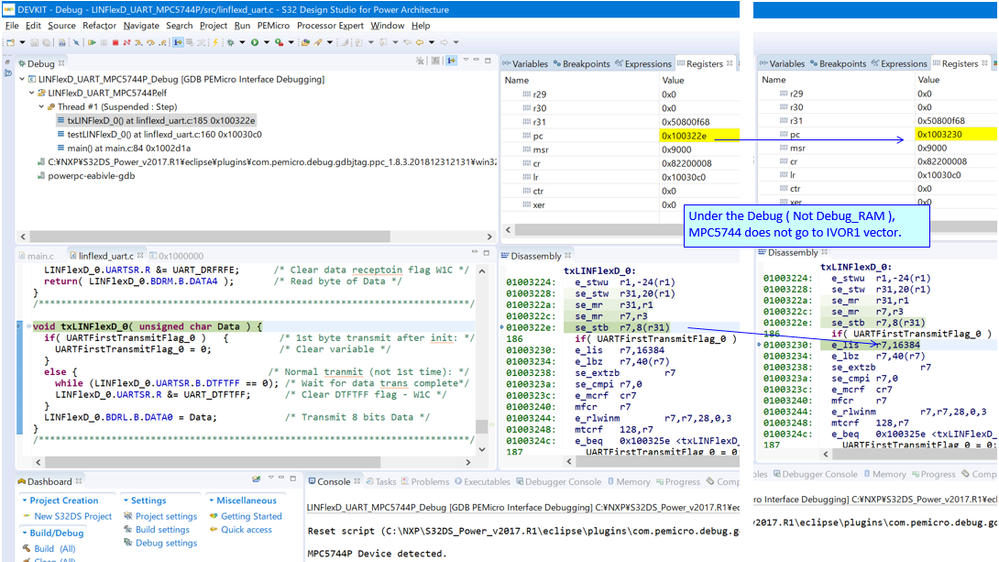

1. Under the Debug mode(It is not the Debug_RAM mode),
   I have confirmed that MPC5744P did not go to IVOR1 vector such as the below Figure-1.
2. Under the Flash mode,
   I have confirmed that MPC5744P operated correctly according to the software.
   ( Note : I can not confirm it on step by step because it is under Flash mode. )

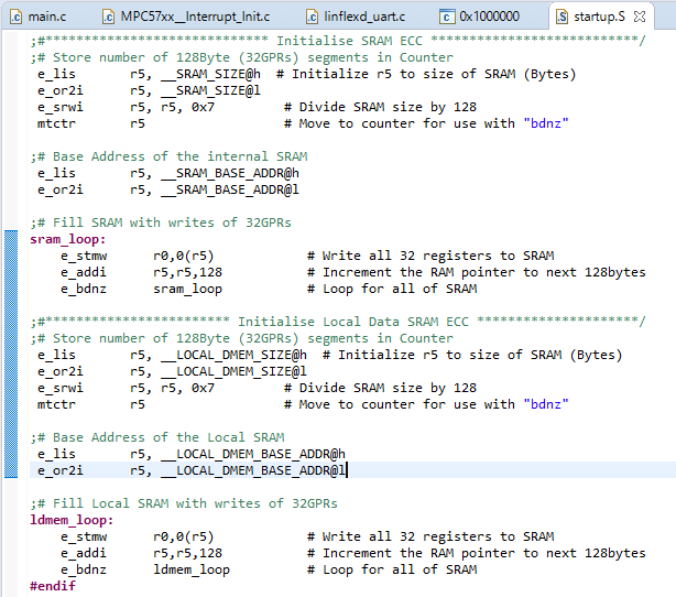

3. I checked a part of the startup.S file such as below Figure-2.(Note 1)
   I could not find the difference because I did not modified it. ( It was created at Example program only.)

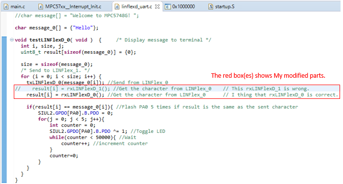

   (Note 2) My modified parts are shown in the below figures.(See the Filgure-3-1 & 3-2)
                And, for the up-loading the my project files, I have made LINFlexD_UART_MPC5744P project again, today.
