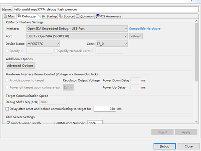

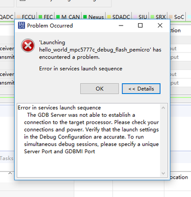

I purchased "MCSPTR2A5775E: MPC5775E Development Kit for 3-phase PMSM motor control targeting ISO 26262 ASIL D" and followed the guide on the official website. I don't know how to solve this problem. Urgent, waiting for a reply online,
No port occupation under win10
Error in services launch sequence
The GDB Server was not able to establish a connection to the target processor. Please check your connections and power. Verify that the launch settings in the Debug Configuration are accurate. To run simultaneous debug sessions, please specify a unique Server Port and GDBMI Port

I had same problem as you did, is your problem is solved? Can you tell me how you solved it?
2,715 次查看
易衍玖
I changed 4 computers to solve the problem, probably related to the system version

it looks like you selected MPC5777C device instead of MPC5775E. Try to create project for MPC5775E.
