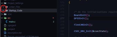

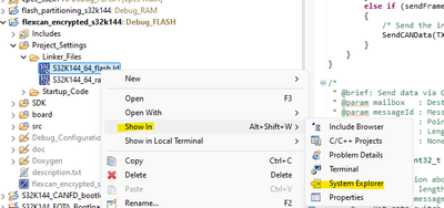

I can see the linker file within the "<project>/Project_Settings/Linker_Files/" directory in the IDE, however it is just a shortcut to the file in the "Shared Linker Directory" and it does not actually exist in the project. Here is an example using the flexcan_encrypted_s32k144 demo.

2. I manually changed the directory in question 1  to "../Project_Settings/Linker_Files/S32K144_64_flash.ld", and put a modified linker file in the "<project>/Project_Settings/Linker_Files/" directory. This allows the project to use the modified linker file rather than the default one, and for the file to be pushed to GitHub, as desired. However, the files listed under "<project>/Project_Settings/Linker_Files/" when viewed using the IDE are still the linker files located at the "Shared Linker Directory" directory rather than the linker files located within the project. (I.e., if I open one of the files listed here, it opens the file that is stored at "Shared Linker Directory".)
How can I update the project so that the files listed under the "<project>/Project_Settings/Linker_Files/" directory within the IDE are actually the files that are located within my project?

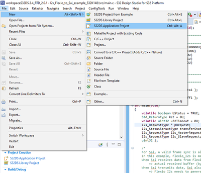

I see, I think the issue may lie in importing a project, rather than creating a new one to configure. Could you try creating one and copying over the configuration?
"File -> New -> S32DS Application Project"
Julián

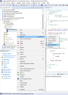

1. I am not sure how you have concluded that the linker file shown in the workspace is actually a shortcut. You can actually look for the file by using the "Show in file explorer" option:
This shows the files under the workspace directory. The shared linker directory is used but only as reference for creating the project. Not when editing the file.
"${workspace_loc:/${ProjName}/Project_Settings/Linker_Files/S32K144_64_flash.ld}" does refer to the internal project directory, not the shared one. "workspace_loc" simply returns the workspace directory (e.g. C:\Users\user\workspaceS32DS.3.5) and "project_name" returns the name of the current project, giving a full directory to the current project.

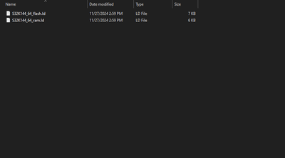

1. I am unfortunately unable to emulate the behavior you are showing with your linker file. When I click "Show In -> System Explorer", I am taken to the shared linker filer directory and not the workspace directory, as shown below. I have not changed anything in the settings and the script files -T is still set to  " "${workspace_loc:/${ProjName}/Project_Settings/Linker_Files/S32K144_64_flash.ld}".
2. When I open the project in VSCode, the linker file does not appear/exist because it is a shortcut and not actually saved in the workspace as mentioned above.
Please let me know if there was anything you did on your side or if you changed any settings to have the linker file saved in the workspace.
Julián

Yes this works. When I look for the linker file for the new application project it is properly in the project's directory. Thanks for your help!
