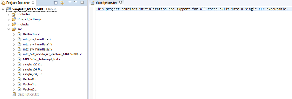

alexanderfedoto
You can take a look at the SingleElf_MPC5748G project in S32DS exmaple projects for the reference.
