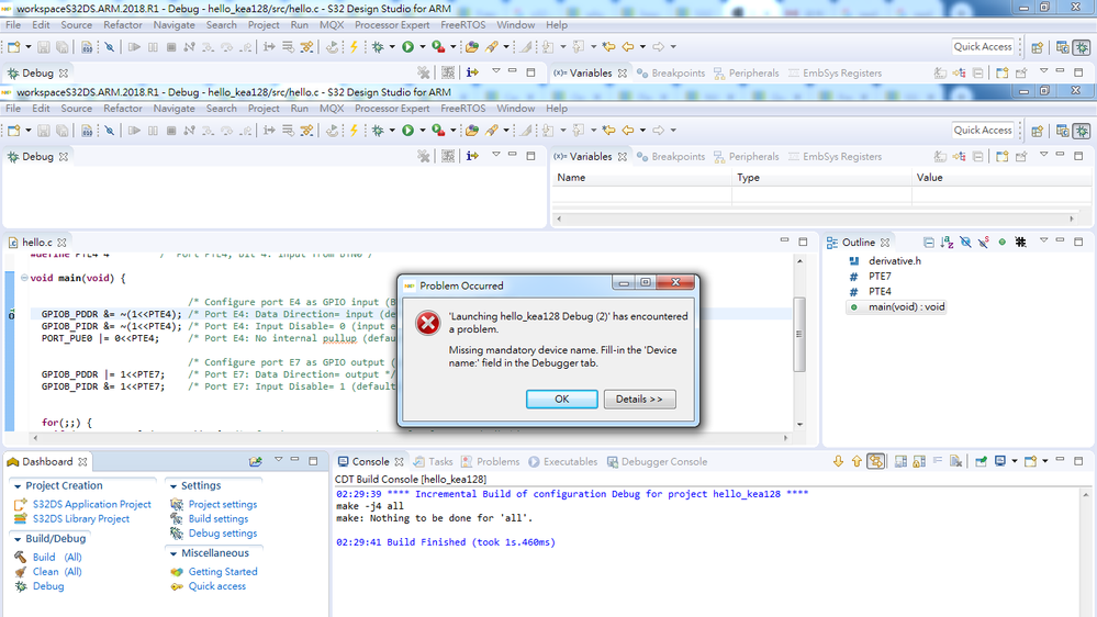

Hi, Sir :
   I use the FRDM- KEA128 Q80 and developed the code on the S32 Design Studio.
I find there is SWD connector on the demo board. So I try to use the LPC-LINK2
( in J-link mode ) debug the code. But it always fail to work. What should I

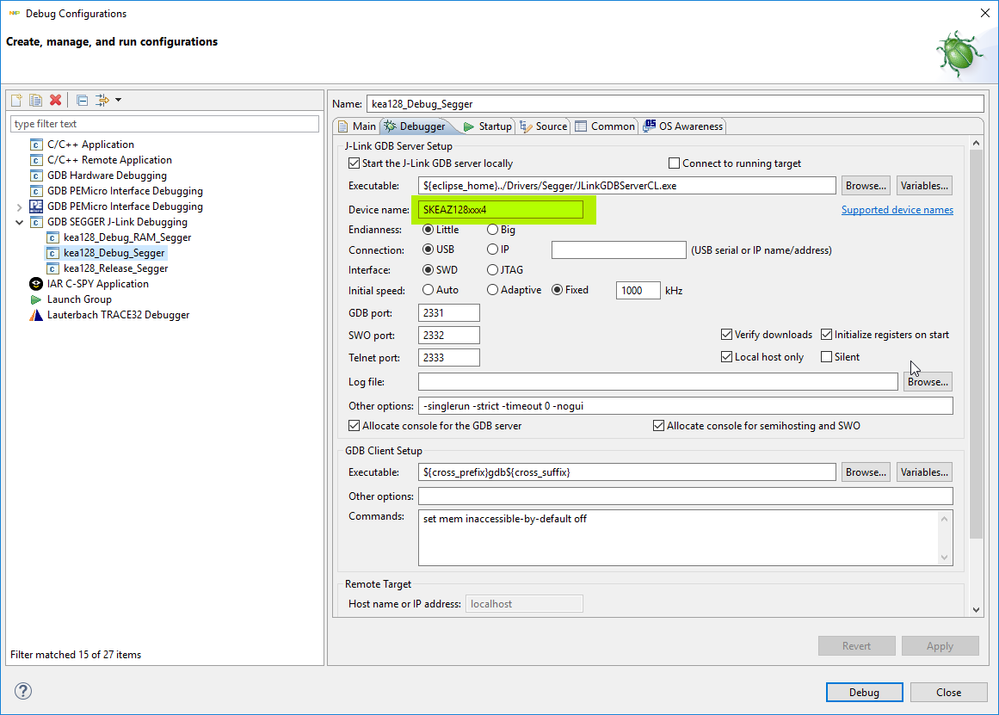

for some reason there is missing device name in your debug configuration:
Jiri
