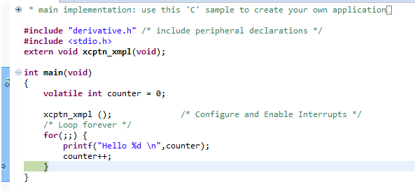

Now add some I/O e.g. printf() into your project:

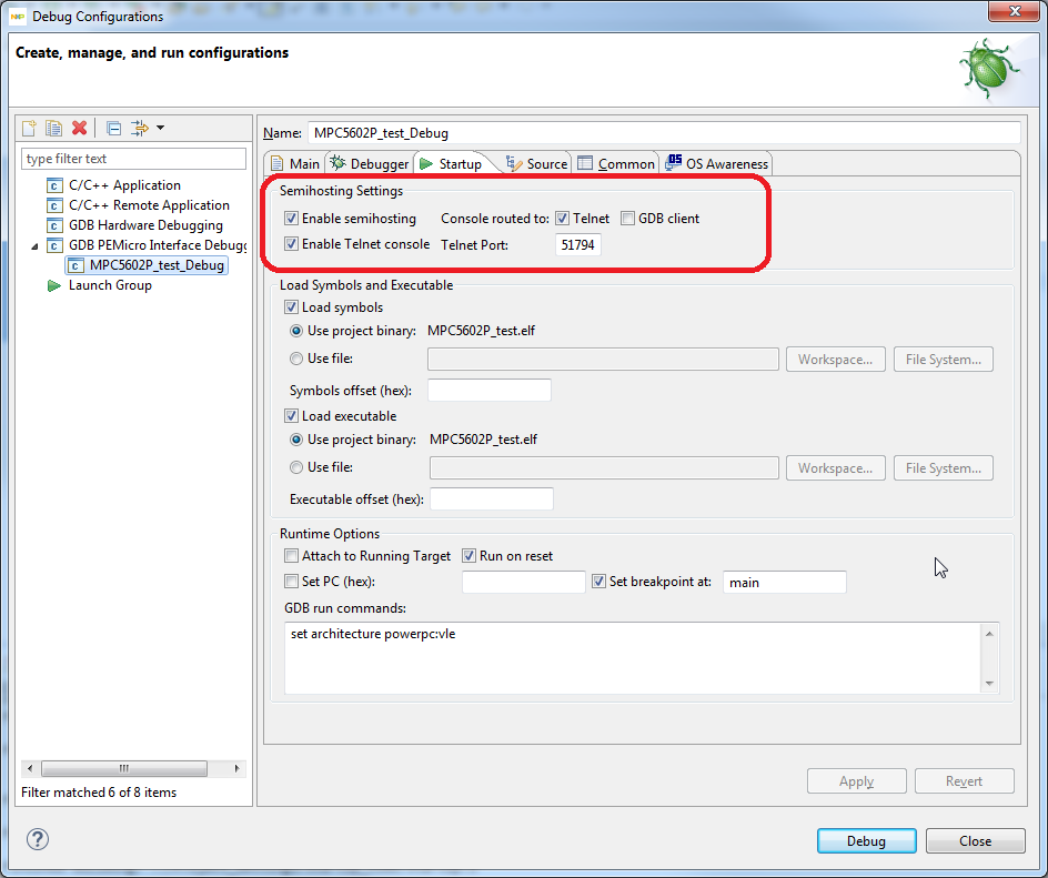

The debug configurations created by the project wizard should have semihosting option already enabled so you can just press debug button:

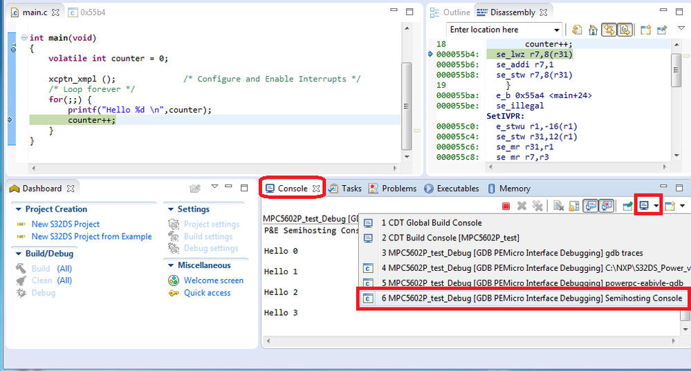

When the debug session is established switch the console to "Semihosting Console" and check the output. You should observe printf() outputs within the console:
