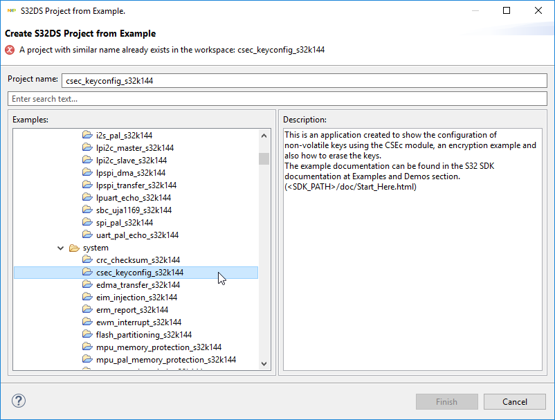

jiri_kral

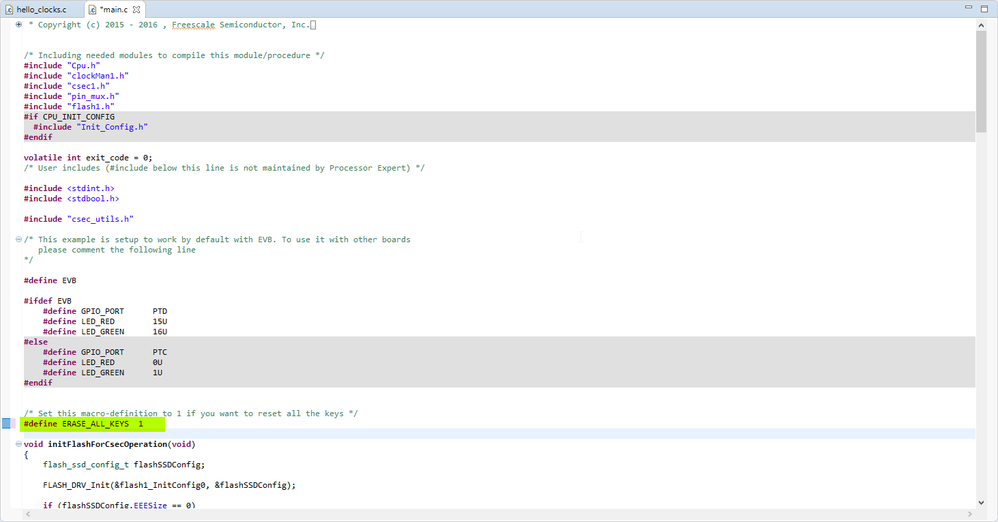

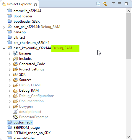

I see. So - in my opinion the easiest way how to "reset" your hardware is use csec_keyconfig_s32k144 example:
Enable erase all keys in main.c source file:
This example erase flash area and restore flash config to default value. Be sure that you are running this example as RAM target:
If it doesn't help - can you please share your project? I'll test it on my EVB and try to find recovery process.

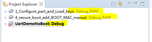

For this issue, I refer the chapter 4.4.3.2 Automatically using CSEc of AN5401.pdf.
   1,I debug the "UartDemo" porject for burn the code into Flash.
   2,I debug the "1_Configure_part_and_Load_keys" project for load the ECU_KEY. and I use the Debug_RAM.
   3,I debug the "4_secure_boot_add_BOOT_MAC_manual" project for config the secure boot. and I use the Debug_RAM.

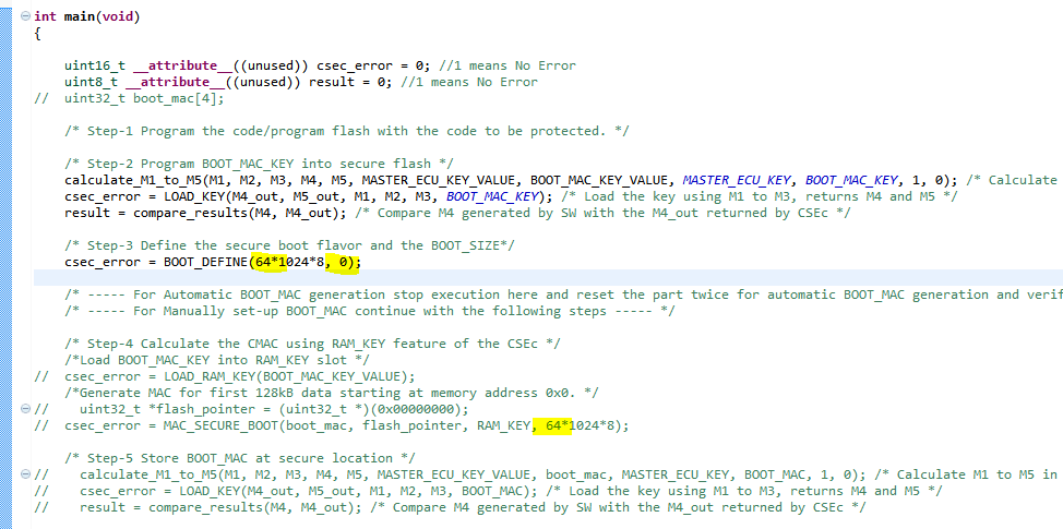

I modify "4_secure_boot_add_BOOT_MAC_manual" project like this:
I change the BOOT_SIZE and boot flavor. and run it use Debug_RAM. I want to calculate the BOOT_MAC automatic. I power off my hardware and wait a few minutes, then I power on my hardware, I think it will run Flash code, but it doesn't. Then I power off and power on my hardware several times, But it doesn't work.

I refer the AN5401.pdf, I find the mode flavor = 0(Strict Sequential Boot Mode) can not use automatic BOOT_MAC caculation.The reset pin is always low.I can not debug the "csec_keyconfig_s32k144" example.
I can't submit my project in this reply.
the "UartDemoNoBoot" project is a simple project that can print some information when run from flash.
I do not modify the "1_Configure_part_and_Load_keys" project in AN5401SW.zip
I modify the  "4_secure_boot_add_BOOT_MAC_manual" project like last reply.
