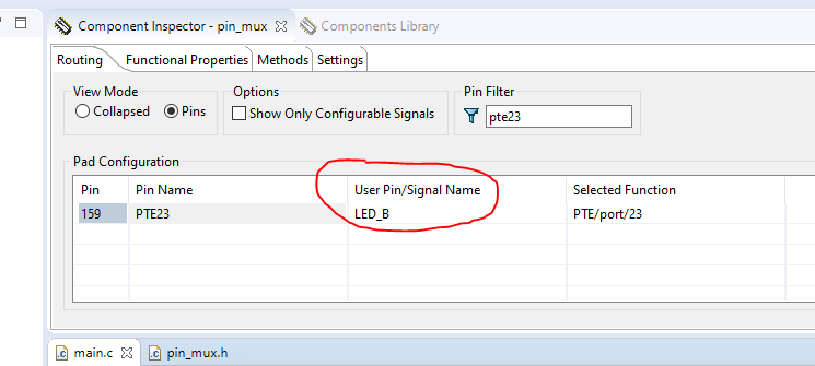

I just started to use S32 Design Studio. First I tried to enable an LED by a Switch.
This worked well so far. I always used the Pin number to use the driver functions. But I want to use user name of the Signal instead of the numbers. So I found the option "User Pin/Signal Name"
I filled in a desired name there, but I was not able to use this name. It always showed "LED_B undeclared..." during building.
So how can I use this user Pin name?

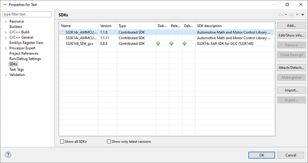

S32 DS Version 2018.R1 (Build id: 180326)
SDK Version: 0.8.6

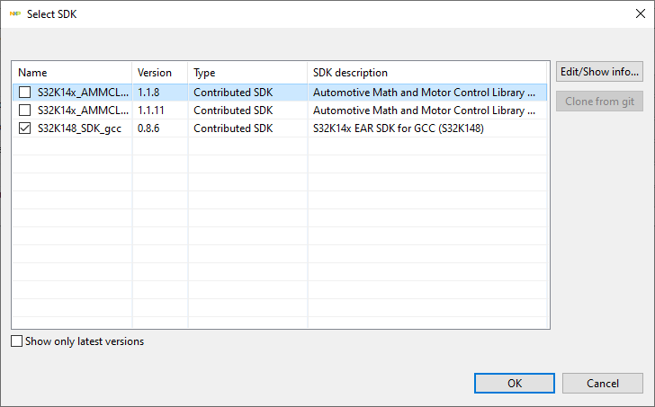

I'm using the following SDK in the project:
I'm using the S32K148EVB-Q176 Board for my tests. And I created a new project (not using a template).
I cann not choose this SDK RTM_3.0.0 when I'm creating a new project:

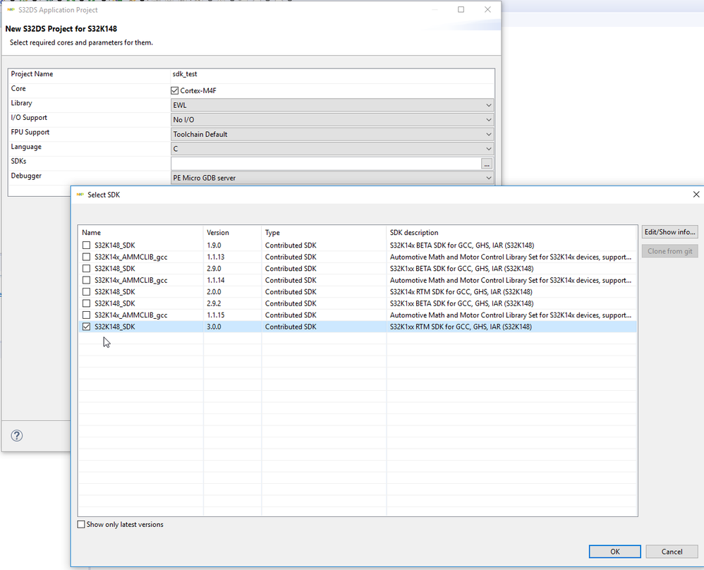

with correctly installed latest update you should see something like this - when you create new project:
Here is document how to update S32DS https://community.nxp.com/docs/DOC-343020  . Hope it helps.

Now its working correctly with the new SDK version. Thank you for your tipps. :-)

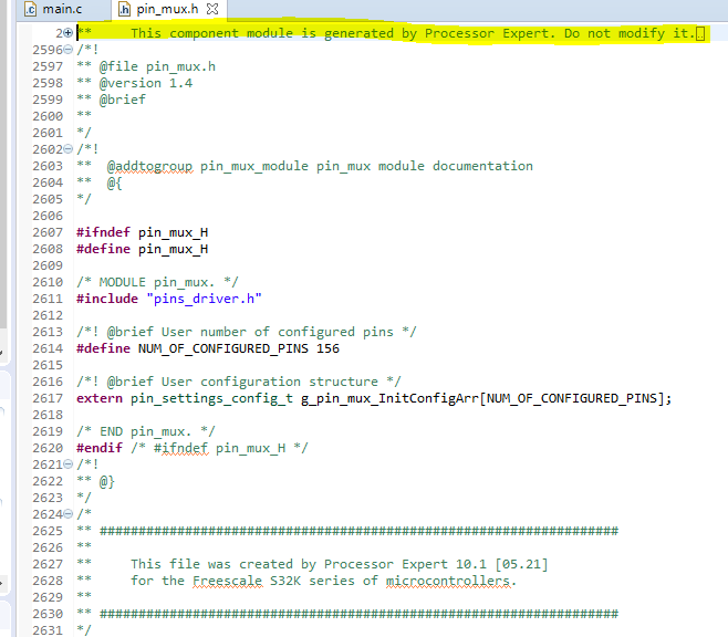

Thank you for your answer. I tried this out, but it seems that it is not working for me. I tried this out, but there was acompilation error that LED_B_PIN is undeclared. Then I checked out the "pin_mux.h" file and I also included it in the source file. But the content of this file does not shows something like _PORT or _PIN.
Only in the comment part at the top, there is my choosen name listed. But no Source Code is generated with that name (see attached pictures):

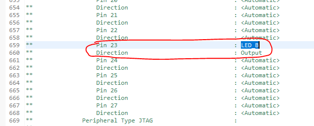

The yellow marked part includes a long comment section with the settings. There I could find the followed lines:
