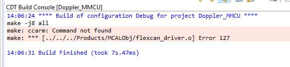

I am using S32K146 SDK ver 3.0.0 RTM
Waiting for your prompt reply

It seems the makefile refers to GHS toolchain.
If you intend to build the project under GHS toolchain please make sure GHS eclipse plugin and GHS toolchain itself (multi) is installed and configured correctly on your machine.
see e.g.
GHS Compiler error in S32DS
https://community.nxp.com/message/1110877
Hope it helps.
Stan

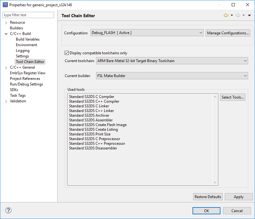

jiri_kral
what's you build toolchain?
Jiri
