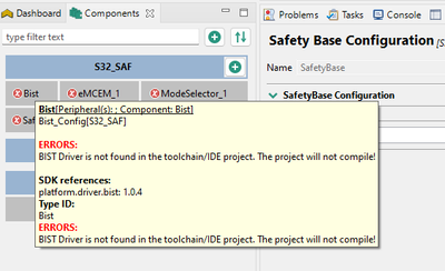

I've just installed S32DS v3.5, I tried to include SAF driver for S32K3 with update archive, but when I try to include new components I have the issue below.
Someone have a good solution about this issue?

This error occurs because you have to generate all the needed configurations. For this select the current project. Select the "S32 Configuration Tool" menu then click on the desired configuration tool (Pins, Cocks, Peripherals, etc...). Clicking on any one of those will generate all the components. Make the desired changes (if any) then click on the "S32 Configuration Tool > "Update Code" button.
