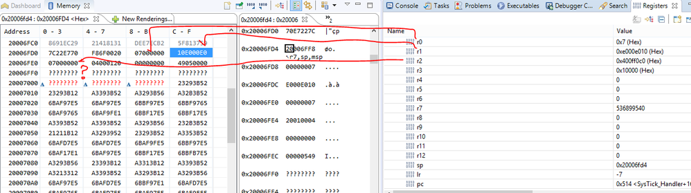

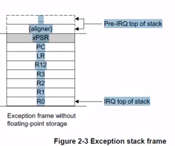

Shall S32k144 processor push information onto the current sack during Systick handler?
Other EV boards such as STM32 and TIva boards automatically save R0-R3,R12,LR,PC,PSR... as in the following figure.
In case S32k144 is not designed to do stacking automatically, how can I add assembler POP and PUSH code in a C source file by using S32DS? How can I save LR and PC values (is Lr equal to R14 and PC = R15)?
I'm asking this because I cannot see during debugging that the Registers are being stored in RAM automatically when the debugger hits a Break Point in Systick.

I'm not sure why you get the question marks there.
But you should compare the core registers before it enters the SysTickHandler with the memory (stack) content in the handler:
This is what I see:
BR, Daniel
