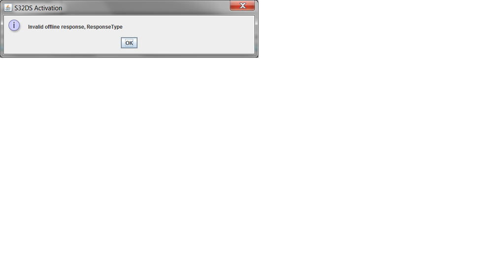

pmz1
I am having the same problem. While attempting an offline activation, all files are generated. I give the activation code provided by NXP. What is the solution to this?S32DSError.png

pmz1
Hello Alice,
I have just tried the activation code you supplied with the same results. The installer fails with “Invalid offline response, ResponseType”. I have logged in as the Administrator and it produces the same result. At this point I do not know what else I can do. I hope you can help. There may be some Java or Microsoft update that is preventing the installation. There is not much I can do about this because our IT group has complete control on what updates are pushed on our machines. We are pretty locked down here in terms of computer configurations/settings.

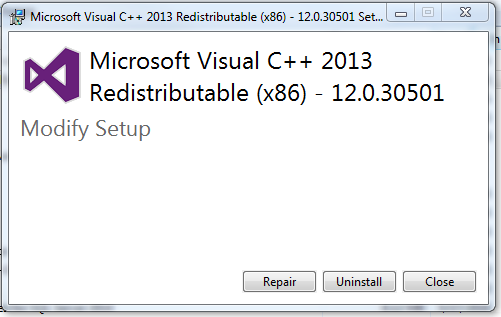

Hello Paul,
Yes, it need install the "Microsoft Visual C++ 2013 " when isntall S32DS on Windows :
Hope it helps
Alice
16,444件の閲覧回数
pmz1
Hello Alice,
My computer already has Visual Studio 2013 installed on it (hence VC2013 is present). When I run the S32DS installer I select the “Repair” option for the VC2013 redistributable. Is this correct?
Paul Zak
16,444件の閲覧回数
Hi Paul,
Yes, and please use the Activation  code :
37D6-B186-B306-B6AA
If you have internet , please select the online mode ,
you can also use the offline mode refer to the guide i mentioned .
Alice

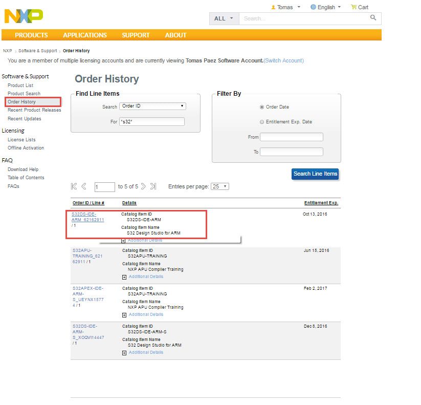

TomasPaez
Can you please add the entitlement ID you are using. You can get this from your web portal on SW Licensing & Support site.
Go to order history and look for the entitlement ID, must be named S32DS-IDE-ARM_XXXXX
Check this video on how to access to your licensing portal.
How to access software products and licenses|NXP
