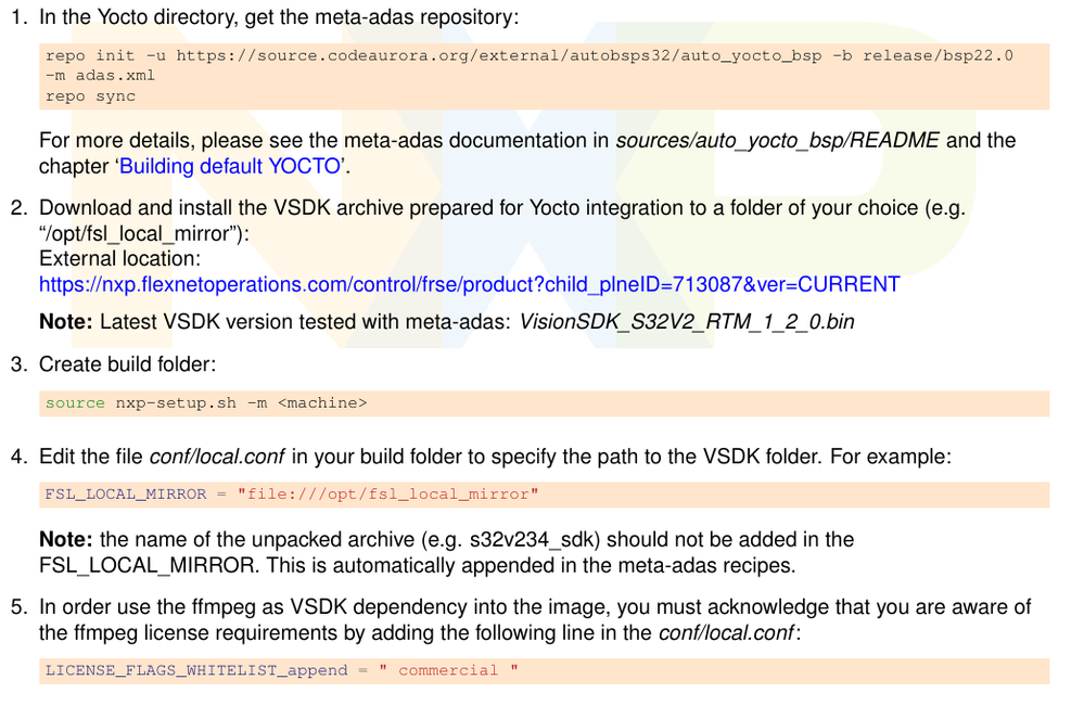

Dear all:
   I want to integrate vision SDK in yocto environment and operate according to document Auto_Linux_BSP_22_0_S32V234_User_Manual.pdf. My computer is Ubuntu16.4, and the version of VSDK is VisionSDK_S32V2_RTM_1_3_0_HF1.bin
. The steps are as follows:
However, I compiled the following errors:
ERROR: sequencer-1.0-r0 do_compile: oe_runmake failed
ERROR: sequencer-1.0-r0 do_compile: Function failed: do_compile (log file is located at /home/nice/work/fsl-auto-yocto-bsp/build_s32v234sbc/tmp/work/s32v234sbc-fsl-linux/sequencer/1.0-r0/temp/log.do_compile.8312)
/home/nice/opt/VisionSDK_S32V2_RTM_1_3_0_HF1/s32v234_sdk/libs/isp/sequencer/kernel/build-v234ce-gnu-linux-d/../src/seq_func.c: In function 'SeqDrvDataInit':
/home/nice/opt/VisionSDK_S32V2_RTM_1_3_0_HF1/s32v234_sdk/libs/isp/sequencer/kernel/build-v234ce-gnu-linux-d/../src/seq_func.c:541:5: error: implicit declaration of function 'init_timer' [-Werror=implicit-function-declaration]
init_timer(&sWDTimer);
ERROR: Task (/home/nice/work/fsl-auto-yocto-bsp/sources/meta-adas/recipes-libs/isp/sequencer/sequencer.bb:do_compile) failed with exit code '1'
What are the following questions? Is the version of VSDK_1.3.0 compatible with the version of BSP 22.0?
