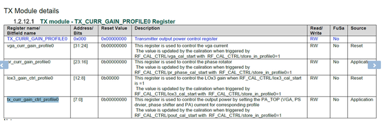

So as a test you could request to test 1TX per TEF82xx (so 4TX in total) and see if the is an issue (or perhaps on a specific TEF82xx). Next would be to analyze the supplies and investigate if they remain stable when the calibration is started.
Also noting PoutCal error, this can occur if the maximum tx_curr_gain_ctrl_profilex is reached, however this is not expected for 10dBm output power. Please refer to the attached picture. The customer can try and read this register to check the value, if the value is 255 (maximum) at 10dBm, this may indicate problems with the RF design on the PCB.
