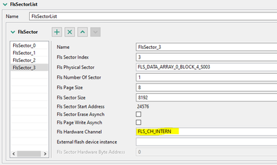

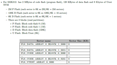

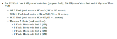

S32K344 allows to use internal flash for Fee. As User manual of Fls module in Release RTD AUTOSAR Ver 1.0.0:
So, it's possible to use FEE with internal Flash.

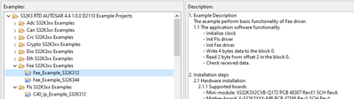

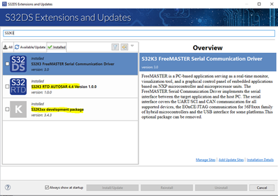

For Fee example for S32K3, you can update your S32DS SW to latest version, which is installed S32K3XX development package and S32K3 RTD Autosar 4.4 includes:
Then you can find Fee example for S32K344 and S32K312 included
Please note that select Fls channel is FLS Hardware channel is 'FLS_CH_INTERN' to use internal flash config

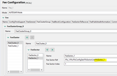

Later, in configuration of FEE module, select the corresponding Fls sector defined previously in Fls
