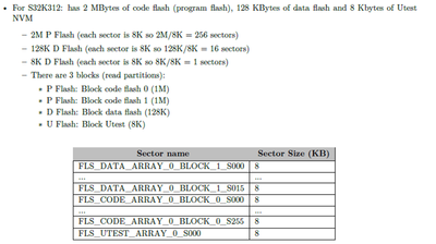

S32K344 allows to use internal flash for Fee. As User manual of Fls module in Release RTD AUTOSAR Ver 1.0.0:
So, it's possible to use FEE with internal Flash.
cuongnguyenphu_1-1650270806493.pngcuongnguyenphu_1-1650270806493.pngcuongnguyenphu_2-1650270814489.pngcuongnguyenphu_2-1650270814489.png

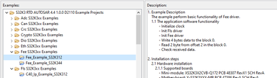

For Fee example for S32K3, you can update your S32DS SW to latest version, which is installed S32K3XX development package and S32K3 RTD Autosar 4.4 includes:
Then you can find Fee example for S32K344 and S32K312 included

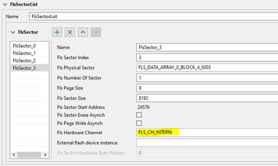

Please note that select Fls channel is FLS Hardware channel is 'FLS_CH_INTERN' to use internal flash config

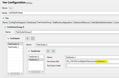

Later, in configuration of FEE module, select the corresponding Fls sector defined previously in Fls
