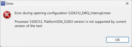

Hello.
I try import S32K312 example projects into S32DS v3.5.
S32K312 Example Link:
https://community.nxp.com/t5/S32K-Knowledge-Base/All-Example-S32K312-DS3-5-RTD-3-0-0/ta-p/1790004
I have below error message.

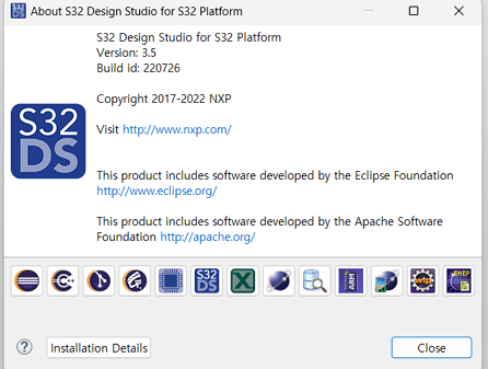

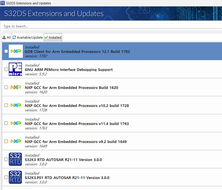

Here is my S32DS information:
How can I get S32K312 example projects that working with S32DS v3.5 ?

I checkd the files in S32K312_I2C_LPI2C_DMA_working\RTD\src. This project was based on S32K3_RTD_3_0_0_P01_HF02_D2305.
So please install S32K3 Real-Time Drivers Version 3.0.0 P01 HotFix 02 by refer to HOWTO: offline install S32K3 RTD 3.0.0 in S32DS v3.5.

Hello @Robin_Shen
I can load project after install RTD HF02.
Thank you for support.
