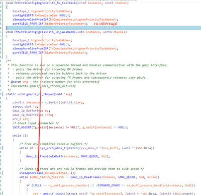

URL https://www.nxp.com/webapp/swlicensing/sso/downloadSoftware.sp?catid=SW32K3-REFSW-D 有一个 LWIP 演示,但它基于轮询模式。我需要一个基于中断模式的演示。

lukaszadrapa
Hi @david2023
I don't think we have other examples for this. LWIP stack is supposed to be used together with FreeRTOS, so it is implemented in this way.
