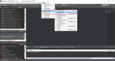

My customer has a problem with S32 Design Studio Arm 2.2, the components window is missing, and in window -> show view, this is no option for components.
Do you know how to solve this problem?

is the customer's project based on SDK? The components view is available only for project with attached SDK:
You can check it in project properties.
