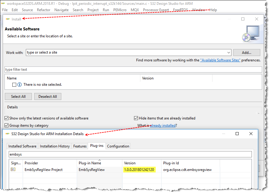

Hi Jakub,
Are you able to configure the EmbSys Registers and then select the chip for it?
Here is the version of my EmbSysRegView.

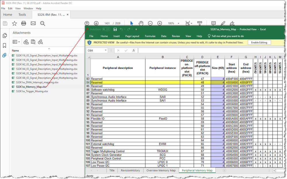

For the Memory View, would you please observe other address that available? 0x40050018 is Reserved for S32K148.

jakub_mielczare
Hi Robin,
Selecting proper device in EmbSys Registers settings solved the issue.
Thank you,
