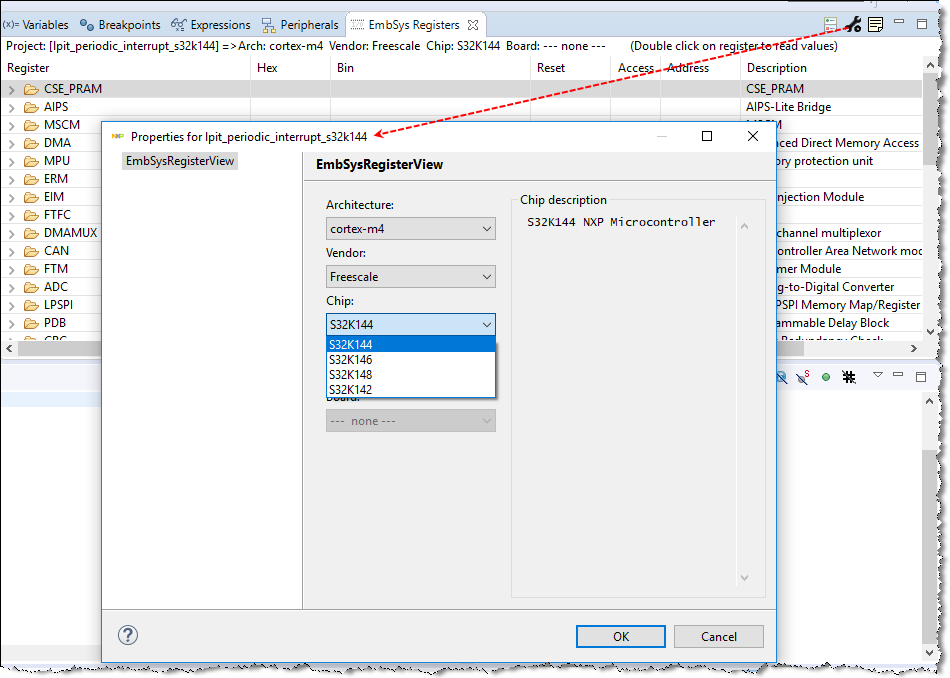

I have a fresh installation of S32 Design Studio for S32K148 (2019 R1).
When I run debug session the EmbSys Registers view is empty (see attached screenshot). The target is paused. Also the Memory View shows "????" in peripheral registers.
Can you help?
Jakub

Hi Jakub,
Are you able to configure the EmbSys Registers and then select the chip for it?

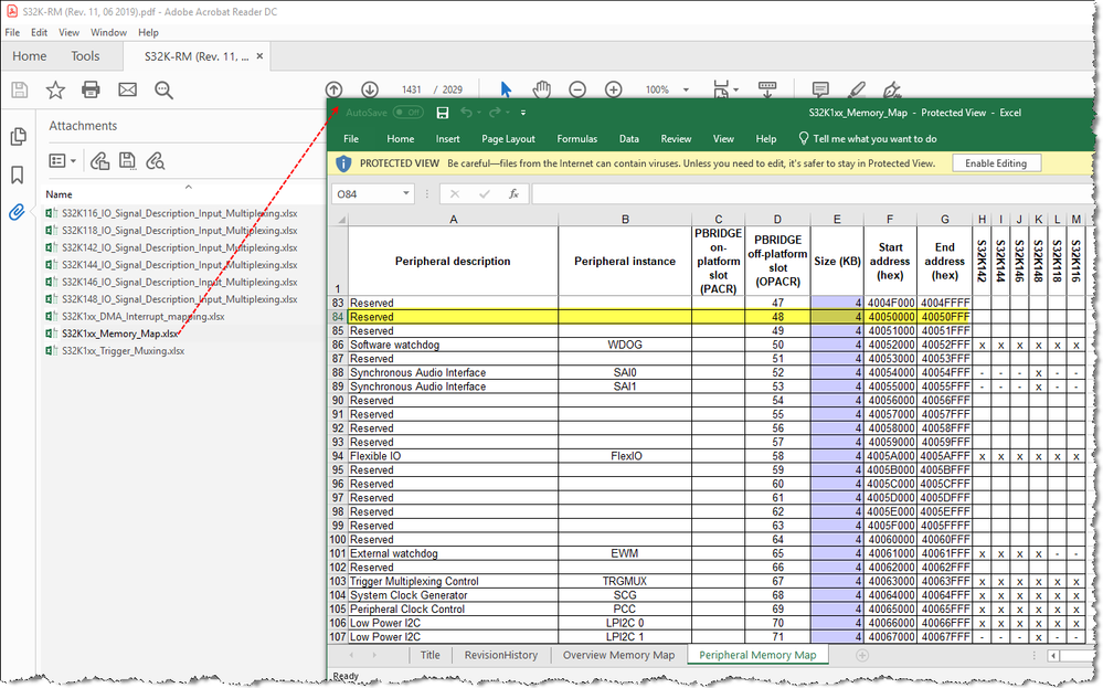

For the Memory View, would you please observe other address that available? 0x40050018 is Reserved for S32K148.

jakub_mielczare
Hi Robin,
Selecting proper device in EmbSys Registers settings solved the issue.
Thank you,
