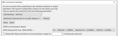

using S32K146 with Multilink and S32 design studio, I flashed the memory area 0x0-0x500 with 0xFF.
thus the option bytes are overwritten
Then when I try to flash, I'm getting error "Device is secure, Erase to unsecure".
I click yes, but then the debugger disconnect and I got this window
As I have flashed 0xFF everywhere, it means I have mass erase enabled, the device is secure and factory access is granted. but it's not the case.
note that I'm using the  CSE and keys are already generated. is it the cause? but what I understand is that the paragraph below is relevant when we try to erase all flash blocs using code, not debugger !!!!!!

mass erase will not work if CSE is enabled. It doesn't matter if mass erase operation is launched by your code or by JTAG/SWD device.
The only option is to run CMD_DBG_CHAL and CMD_DBG_AUTH commands to destroy the partition and then you can run mass erase. But because you can't establish connection via JTAG/SWD anymore and there's no code in the flash that could do that, the device is bricked.
The only option is to replace the chip.
Lukas
