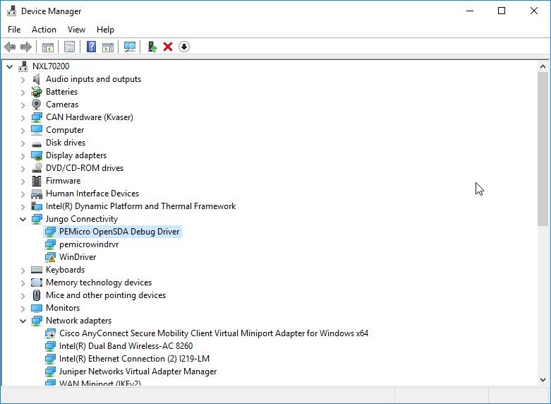

jiri_kral
What about Open SDA, it is visible in Windows device manager:

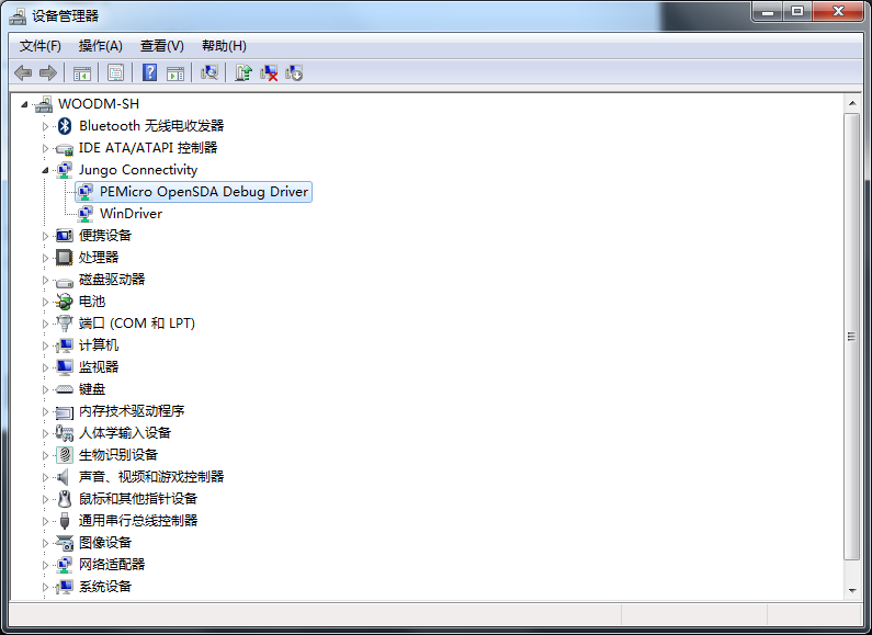

__invited__wood
it is visible in Windows device manager.
50,321 Views
__invited__wood
Hi Jiri
Thanks for your support. it is visible in Windows device manager.

jiri_kral
I'm assuming, that you can also see EVB as a mass storage device on your PC machine, right?
So, try to check continuity between Open SDA chip (the one close to USB) and MCU. Also make sure that pins aren't shorted and MCU is powered. Here is EVB schematic:
https://www.nxp.com/webapp/sps/download/preDownload.jsp?render=true
If you replace old chip with new one  - it should work.
Jiri

__invited__wood
Hi Jiri
Yes, I can see EVB as a mass storage device on my PC machine. what should I do next?
