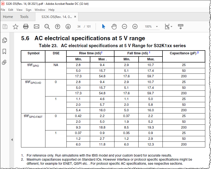

Hello. I'm new into all of this and wanted to ask some questions.
I need to create Signal Generator right now, the signal has to be from any GPIO pin.

Robin_Shen
Hi RV777,
I am sorry to tell you that the S32K1x is not able to generate 1000MHz signal, it's out of the specification "5.6 AC electrical specifications at 5 V range" of S32K1xx MCU Family - Data Sheet
5.6 AC electrical specifications at 5 V range.png5.6 AC electrical specifications at 5 V range.png
By the way, oc_pal_s32k144 is able to generate signal too. You don't need to toggle GPIO by software.

Robin_Shen
Yes, the board can be powered by 12V through J16, but the power supply voltage range of S32K144 can only be 2.7-5.5v.

Robin_Shen
You don't need to toggle GPIO by software. oc_pal_s32k144 is able to generate signal. The signal is output from a pin too.
But S32K144 can not output such high(1000MHz) frequency signal. So You may need to change the MCU.
