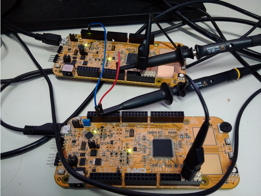

  The problem is when two EVBs are used.
  (1) EVB1 and EVB2 Download the same code as above.
  (2) Connect the EVB2 pulse output signal to the EVB1 Capture input pin. Then connect the ground pins to each other.
  (3) And if you calculate the cycle, 30 ~ 40 us is measured instead of 250us.
  (4) When measured with an oscilloscope, a pulse of 250us is output.

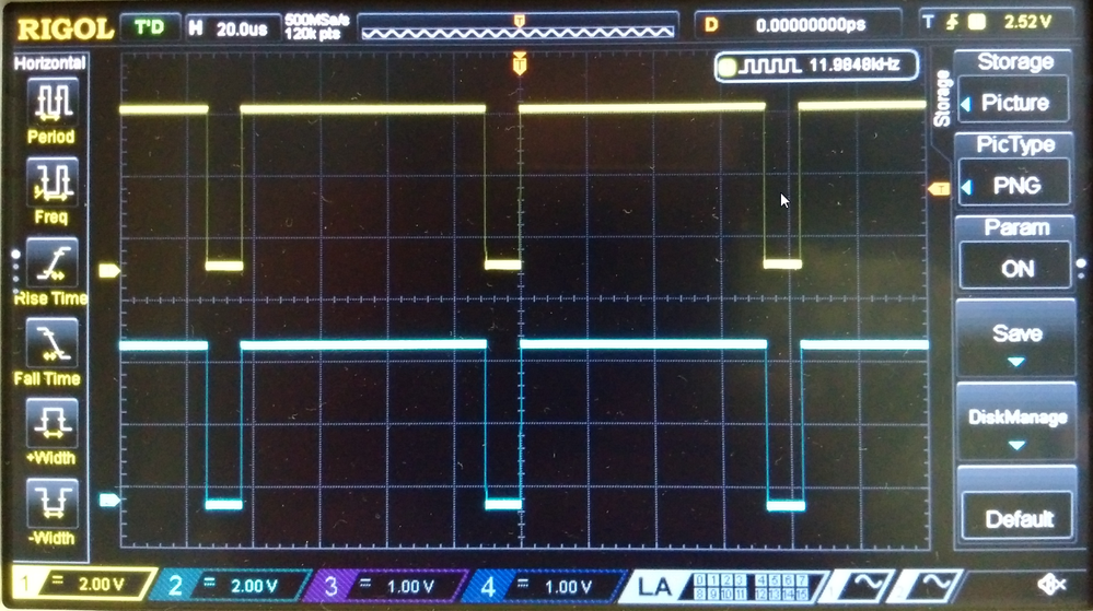

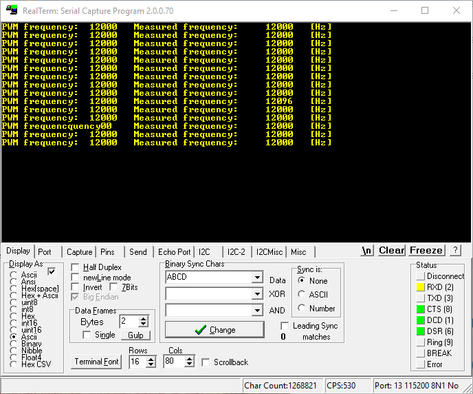

jiri_kral
I updated the example project a little bit (in attachment)  - and for me it is working as expected - terminal output:
Board settings:
Signal shape:
6,429 Views

jiri_kral
that's what I exactly did - connected two boards Input_A to output_B (don't care about Ch2 on scope - I just forgot disconnect it). But I used different example to avoid using breakpoints.
In the non SDK example (the FTM_s32k144) is not handled timer Overflow and you get periodically wrong value. In this particular case - 9 times okay value - then counter overflows (FTM.SC.TOF) - you need to handle this event.
How do you check the DeltaCapture value? Don't forget that these two boards aren't synchronized - so if you are using breakpoints - you will resume in random point of PWM period.
Hope it helps.
Jiri

jiri_kral
So - let's make a summary:
  • I'm using FTM_s32k144 example - as it is, without any modification. Part of code which you shared looks like exactly the same as in the FTM_s32k144 example.
  • I have two boards EVB_1 and EVB_2 with very same program. Both boards have one FTM input on ch6 (PTE-8) and one Output with 4Hz on PTD-15. Let's name these pins as EVB_1_In, EVB_1_Out, EVB_2_In, EVB_2_Out.
Observed behavior on my side with FTM_s32k144 example
Scenario 1: EVB_1_In connected to EVB_1_Out - got correct value 250ms for 9 times, 10th time counter  overflows and I got bad vaule. Also FTM.SC.TOF is set to 1.
Scenario 2: EVB_1_In connected to EVB_2_Out (GND is also connected) - I have the very same result. 9 times okay value, 10th counter overflows and FTM.SC.TOF is set to 1.
The way how is the FTM_s32k144 written doesn't care about counter reset/overflow and uses cumulative global variables for period computing. The counter overflow event is handled as rise/fall edge by the example.
Am I missing something?
It will be very helpful if you can share your project. With standard non SDK  FTM example I can't reproduce your issue - or may be I still don't get it.
Jiri
