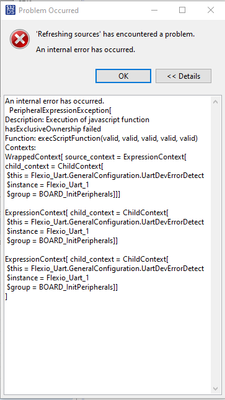

I am trying to add the driver "Flexio_Uart" to a FreeRtos Projekt.
But everytime I am adding the driver via the SDK Components
I get the following error:
Which results in a total mess up of my whole project.
After unchecking the Flexio_Uart driver again, everything goes back to normal.

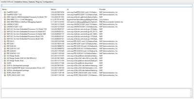

Here is the configuration of all installed packages:

mikedoidge
Hello Christof,
Your issue has been reproduced on our side. I have created an internal ticket for the RTD team. I will share any solution or workaround once it is provided.

mikedoidge
Hello Christof,
I have received the answer. This issue was already discovered and resolved. The new release published this week S32K1 Real-Time Drivers Version 1.0.1 contains a fix for this. Unfortunately, an update to the package for S32 Design Studio was not released. This is in process and will be published some time later. In the mean time, they suggest to workaround the issue by adding Lpuart_Ip or Uart HLD component when using Flexio_Uart_Ip component in configuration.

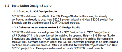

Hello Mike!
I downloaded the new RTD Version and installed it.
But somehow i have a hard time inluding it into the Design Studio.
The release note include the updating process but somehow neither of the both steps mentioned is working:
As you said the Desgin Studio package is not released yet.
But the second Way also doesn't work somehow.
When adding the update site i only can select the two jar files in the installation folder of the RTD, but selecting one of then doesn't work either.
Can you give me a hint, what i can do to make it work?
Christof

mikedoidge
Hello Christof,
The updated RTD package for S32K1 for S32 Design Studio now appears in the S32DS Extensions and Updates menu. See below:
I'm not sure why it doesn't also appear on the download site, but you should be able to take it from here and resolve your issue.
Also note, it will appear as a new item in the list, not as a replacement for the original 1.0.0 package. Usually we try to add them so they replace the original one in the list, but it was not the case this time.
Mike
