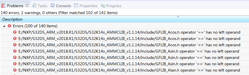

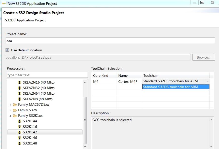

1)According to the chapter 3.11 of document "S32K14XMCLUG.pdf", I need to choose ToolChain when building a project. My target is S32K14x, so I should choose “ARM Bare-Metal 32-bit Target Binary Toolchain”as Fig.1. But actually my S32DS has only “Standard S32DS ”to be selected, as Fig.2. How can I get the “ARM Bare-Metal 32-bit Target Binary Toolchain”option?
2) I chosed “Standard S32DS ”as ToolChain, then complete the rest step of the document. I include header "gflib.h" in my source, because I need to call the function "GFLIB_SinCos_F32( a, &b, GFLIB_SINCOS_DEFAULT_F32 )", and then build my project. All errors are due to the Automotive Math and Motor Control Library, as Fig.3 shows. I guess it may due to the wrong choice of ToolChain. Can you solve my problems?

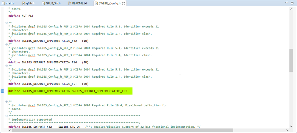

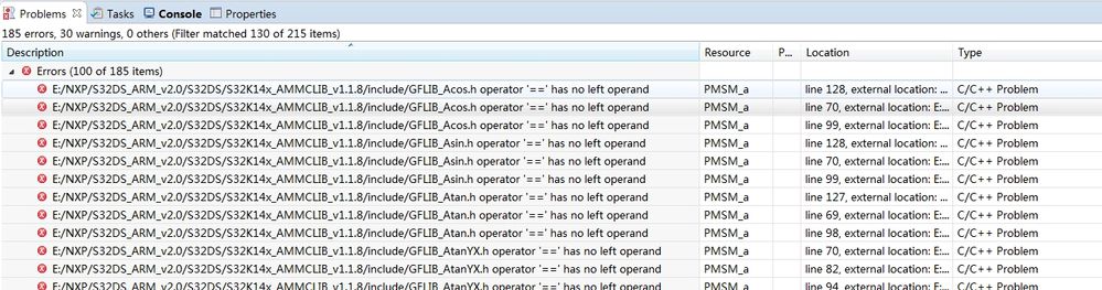

But there are errors after building, as the Fig. below. I check the library source and find "SWLIBS_DEFAULT_IMPLEMENTATION" seems undefined. There is also no example project for library"S32K14x_AMMCLIB" in S32DS 2018R1.
The attachment is my project, can you  check it for me? The source comes from sample code of function GFLIB_SinCos_F32 in S32K14XMCLUG.pdf.

you need to define  SWLIBS_DEFAULT_IMPLEMENTATION macro in SWLIBS_Config.h file:

nanshang
I try to define SWLIBS_DEFAULT_IMPLEMENTATION in  file SWLIBS_Config.h,and then include it in main.c, but there is still error as the Fig. below.
The attachment is my project.
In fact, I had tried to define SWLIBS_DEFAULT_IMPLEMENTATION as 3 before consulting you, the same error occurred.
Maybe there are some other configurations need to be done.

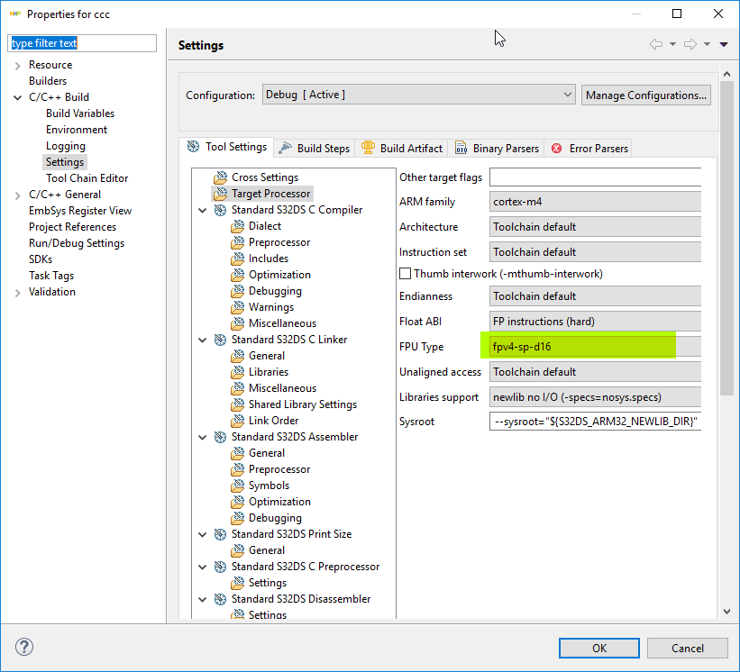

make sure that you have selected Float ABI to hard:
Also check the .args file if contain all settings:
Sometimes there is missing -mfpu argument. If it is your case - double click on fpv4-sp-d16 option in project properties:
Hope it helps
Jiri
4,897 Views
nanshang
I had selected Float ABI to hard, but there is no FP settings in the .args file. It is still missing even after double click on fpv4-sp-d16 option. Then I added it manually, but it returned to th original state after building. After many times of "double click", FP settings finally appeared and errors disappeared.
