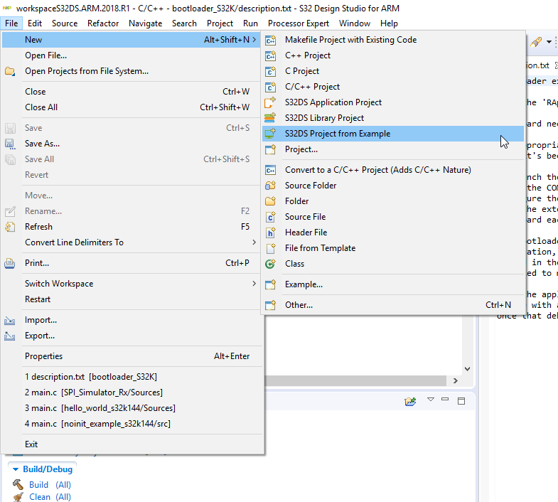

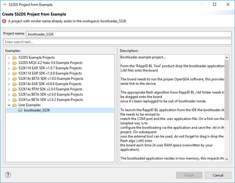

1. HOWTO: Generate S-Record/Intel HEX/Binary file
2. the program (App) start address you can set in linker script file. Please see bootloader_s32k example:
