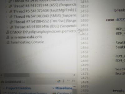

hello experts,there is a issue bothers here: when I Insert a break point into wherever line in whichever project in this work space it looks like this,and the break point can't be active.
I want know that which setting should I change to make the break points can be actived again?

Hi @ScottXing ,
First of all, check if the "Skip all breakpoints" option is enabled, if so, this causes this behavior, please disable it.
