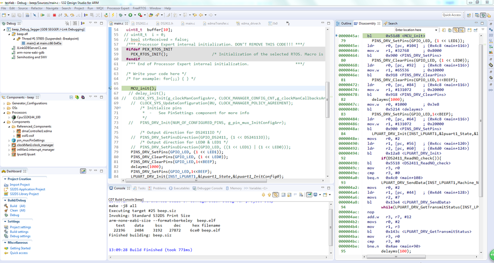

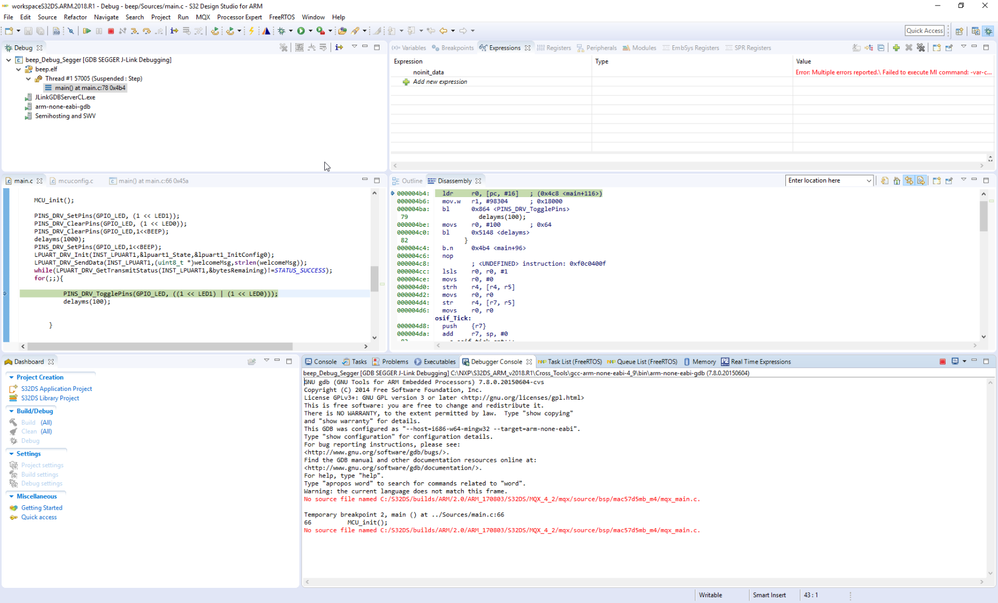

I had used S32 Design Studio for ARM Version: 2018.R1 to make a project and  Segger J-Link V8 to debug. When I debug the project,whatever singlestep debugging or run function, the program would run to the adress 0x00000000 and had warning failed to execute MI command.Forward your help,thinks.
Image 1 Start debug
Image 2  Run out of the project

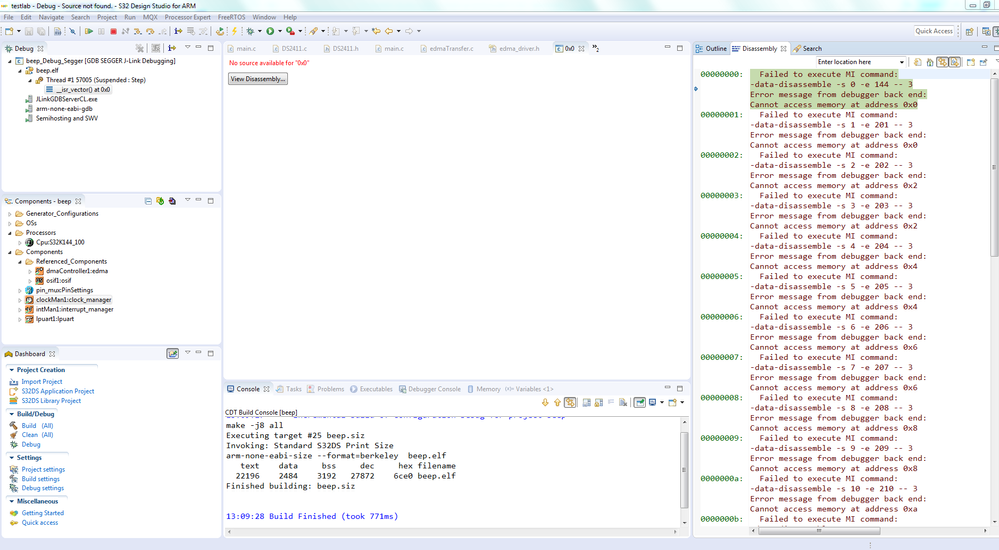

can you please share your project? It looks that your project ends in exception for some reason.

thanks for sharing your project. On my machine I have no issue with debug (tested with OpenSDA segger j-link and j-link lite - I don't have j-link V8).
What is your EVB?
