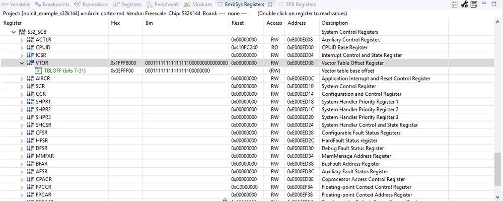

it looks that startup code uses default address for Vector table in RAM. The vector table is properly copied to _RAM_START - in example case to address 0x1FFF800C, but into VTOR register is stored address of RAM beginning 0x1FFF8000:

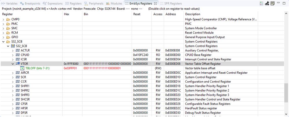

I missed that VTOR value must be align to 128 bytes. Quick dirty fix is just align your .noinit section to 128 bytes in linker file. With this you can use default startup code.

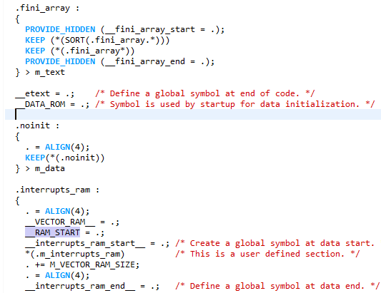

 .noinit :
KEEP(*(.noinit))
. = ALIGN(128);
} > m_data
In this case RAM vector table is moved to address 0x1FFF8080. For more celean solution you need modify startup which is always cleaning RAM from __RAM_START to __RAM_END.

I added example for .noinit section usage - https://community.nxp.com/docs/DOC-342136
Hope it helps.

     Thank you so much for your prompt reply.  I've followed the example and added .noinit section before _RAM_START is defined, but ERROR happened after I add '__attribute__ ((section(".noinit"))) int noinit_data[3];' into the C code file,. The target is S32K142 (I only have this in hand) and I created two types of S32DS project for testing it. one is built on PE platform code, the other is not. here is the results:

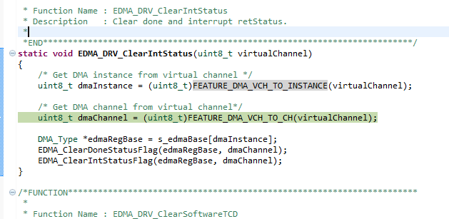

        Inifinite executation ERROR occured during initialize CPU after power up or reset.  I tried to debug step by step , found an error happened while reading EDMA Status which locked execution on this part and can not step over it  sine an unwanted status returnd that causing the executation would not go further.
I pretty sure that all project got no problems before add "__attribute__ ((section(".noinit"))) int noinit_data[3];". and I have check again and again about  the S32K142_32_flash.ld file.
 .noinit :
KEEP(*(.noinit))
. = ALIGN(128);
} > m_data
